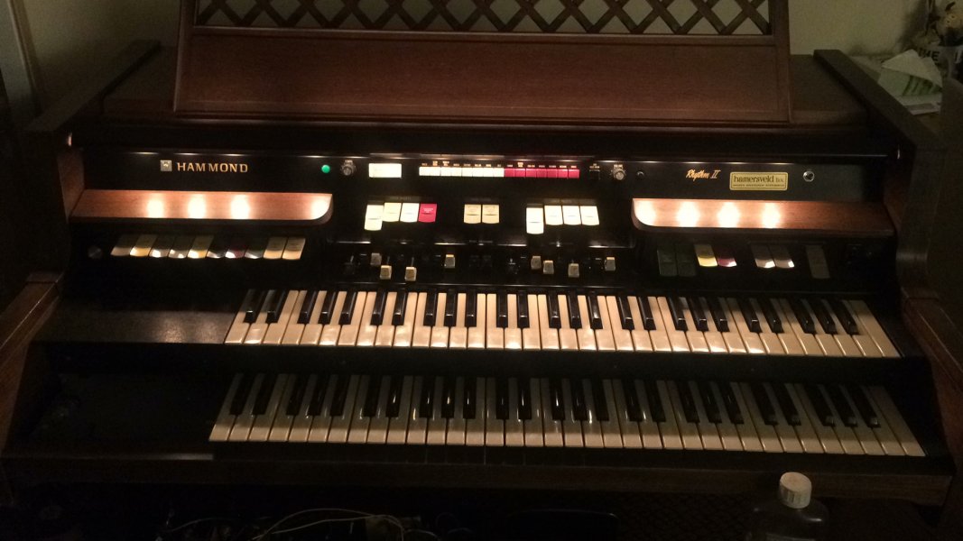

Occasionally i use a cassette deck but it is more of a sentimental value now.
But i do play on my Hammond organs regularly... as i am addicted to their sound .
