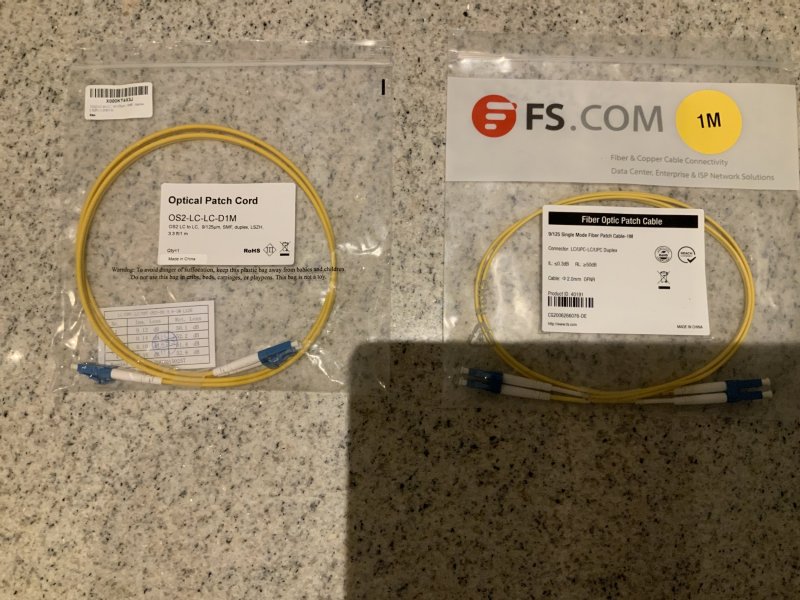

Hi everyone,
recently I have decided to purchase the Sonore opticalRENDU to pair with the etherREGEN. I would like to link up both via optical and have purchased the Finisar FTLF1324 SFP. As I am very new to networking, can anyone advise what do I have to look out for to purchase a set of optical fibre cable to use with the SFP. Thank you.

Hello Simon,
with the Finisar SFP you need a single mode fiber patch cable, they are yellow with blue connectors.
The one from FS.com is thinner and more flexible.
see: image.jpg

Singlemode and with LC connectors at both ends.
