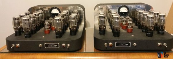

Oh-m'-god--bought a pair of MA-1/3.1s thru USAudiomart.
Dec 16, 2018
57
30
20
76
Phoenix, Arizona USA
#1
https://www.usaudiomart.com/details/649467350-atmasphere-ma1-mk-31-amplifiers/
If that $16,900 retail price is correct, my delivered price is only 38% of RR.. The seller was anxious to get them OUT of his house and shipped them yesterday.. I expect these will sound a bit more 'comfortable' driving the Quad 2905s.. I have more than a complete set of Winged-C 6H13C output tubes on hand and, of course, more than a dozen Tung-Sol oval-plate 'N7s for the input and driver section.

Congrats on those amps which should sound exceptional driving the Quads! :) They do generate quite a bit of heat though... I have a buddy who used to own similar Atma-Sphere amps and he got used to listening in his underwear (and I'm not kidding!) :eek: All the best in the new year!

Very impressive looking! Are you the Jeffrey who owned (owns) an audio shop? Welcome to WBF.

Owned, initially with another Jeffrey, Two Jeffreys Audio, a very parttime effort in my musicroom.. From TAS issue 36:
Long gone, fortunately.
Thanks, I remember buying some records from you back in the latter part of the last century! Larry
