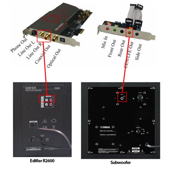

The LFE is the Low Freq effect, the .1 of a 2.1 or 7.1 system. This will have the low pass signal for the sub in one channel, premixed. So the sub won’t have to filter the lows with its crossover from both channels.. then I would use the speaker out on the main card, example #1. otherwise you will have more cables and connections and the sub will have to do the crossover on both channels, if I’m understanding your question setup correctly, it is 4:50 am my time before coffee, oh and good morning !
Not sure if you feed a stereo signal, if you will have an LFE channel to use ? That depends on what your feeding the soundcard and being decoded ? Then you will have to use example 2 , sending the whole signal and let the sub peel off the LF for the sub..

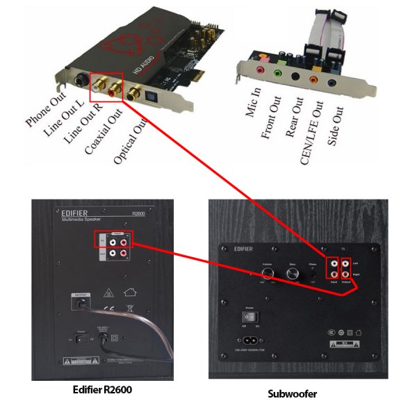

To visualize what I have in mind,
that would be option 1:
and that whould be option 2:
I was hoping to eliminate any IF(s) and MAYBE(s) ;)

Will you always be decoding the .1 channel ? Is there always a .1 from the source for the LFE ?
if you used a pre out with just a stereo signal, then you will need option 2 and use the subs x-over..

Thats my understanding, the LFE is the .1 in a coding scheme. Thats not to say some hardware or software in your card isn’t summing the LFE with all inputs. But basically you need a source with .1 that is extracted and sent down the output summed from all channels, hence the one input.
If you are doing this for two channel music, I would use method 2, with both channels going to
the sub and using the internal crossover. Maybe not ideal in the extra cable and dual Connectors, but you wont have to rely on decoding. If you use 5.1, then method 2 won’t get all the LFE of the 5 channels..

I don’t think the sub needs to be on.. Those inputs and outputs connectors are probably connected in parallel. You could look up the manual To be sure.
I have an SVS SB2000 which has an LFE in and a stereo line in and out. For HT use I use the LFE as the processor sums all inputs.
For my 2 channel system, when I used it.. I used the line in L and R on the sub out from the preamp. most subs will have both or use only The one channel. you can easily test which sounds better.
That Yamaha sub must come with a pigtail “Y” for L and R input or is made for a soundbar or AVR
