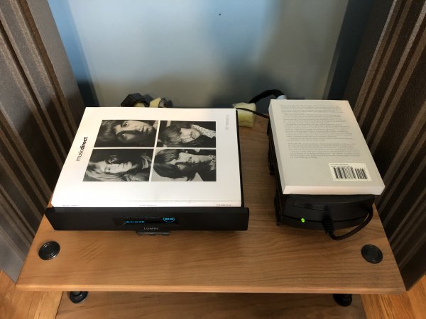

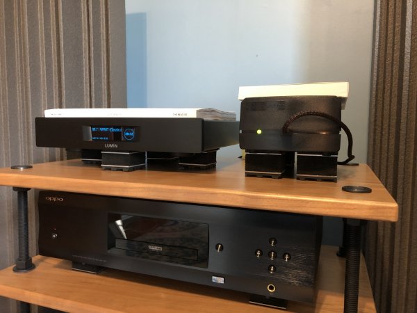

I placed the U1 Mini and Sbooster side by side on the top shelf of my Salamander Archetype equipment rack in the place formerly occupied by the Auralic Aries G2. As per my new usual, I treated all the non-soldered electrical connections of the components and connecting cables with the JENA Electrical Contact Enhancement Fluid recommended by P.I. Audio.
As with the Auralic Aries G2, I'm using the 1.5-meter Discrete USB cable, jointly developed by P.I. Audio and Triode Wire Labs, to connect the U1 Mini to my DSPeaker Anti-Mode X4 equalizer.
I did not try the U1 Mini with its stock power cord. Once I replaced the internal switch mode power supply of the Mini, no AC power cord is used with the Mini chassis; only a DC cable runs between it and the Sbooster.
Neither did I try the Sbooster with its stock power cord. Instead, from the beginning I used the Triode Wire Labs Digital American power cord I'd been using lately with the Auralic Aries G2. That power cord, like all the others in the system, is plugged into one of two P.I. Audio UberBUSSes. Each UberBUSS, in turn is plugged into a dedicated 20-amp circuit where the outlets are the same hand-customized Pass & Seymour 5362A receptacles P.I. Audio used in my UberBUSSes.
Since both the U1 Mini and Sbooster are very light-weight components (neither weighs more than about five pounds), I took advantage of the new Low Density (LD) Equipment Vibration Protectors (EVPs) from A/V RoomService and initially placed an LD EVP under each of the four feet of each unit. My general practice is to place the EVPs directly in contact with the underside of the component chassis at the chassis corners, but I was unable to remove the feet from the Mini and while the rubber feet of the Sbooster are removable, the screws holding the feet stick down from inside the chassis and removing them would require major disassembly of the Sbooster. I thus initially decided to place the LD EVPs under the component feet.
However, this did not work well, the resulting sound subjectively seeming bass thin/light and treble heavy when I compared the file version of tracks played via the USB stick inserted into the Lumin with the CDs from which the uncompressed WAV files were derived played by my Oppo UDP-205. Now, when such files are compared to the CD sound with both the files and CD played back through the Oppo, they are indistinguishable to me on my system. Thus, as in prior experiments, using the EVPs underneath a component's existing feet leads to strange interactive mechanical resonances which affect the subjective tonal balance of even digital equipment.
With further experiments, I found the most satisfactory arrangement of the LD EVP feet under the Lumin chassis, one which restored the sonic equality of the USB files played from the Lumin and the CD track played from the Oppo, to be as follows: Place one LD EVP near the center front edge (just behind but not touching the lip of the front panel). one at the back center edge of the underchassis, one near the left edge midway between where the two Lumin feet are mounted (just inside the lip created by the cover), and one near the right edge midway between where the two Lumin feet are mounted (just inside the lip created by the cover).
For the Sbooster, the sonically most satisfactory arrangement proved to be moving the LD EVPs immediately inboard but not touching the four Sbooster feet, with the edges of the EVPs even with the edge of the Sbooster underchassis.
For lightweight components, I'd generally recommend using the rubber version of the EVPs since this version will keep lightweight items in place on the shelf even when you connect and disconnect cables and operate controls. I thus used the rubber version of the LD EVP for the U1 Mini and Sbooster, neither of which weighs more than about five pounds.
In addition to the LD EVPs, I'm also trying out some new Cable Vibration Protectors (CVPs) from A-V Room Service with the Lumin U1 Mini + Sbooster installation. These CVPs are advertised as affording both mechanical vibration isolation and "static electrical coupling" for cables. As you can see in the pictures, they look like squares of fiberglass insulation, but from the feel of them I'm sure they are made of some other material. Using these keep cables from touching surfaces, such as floors and, as I have them deployed here, other cables and edges of wood shelving. The CVPs can be wrapped around the cables with supplied velcro strips, but I am not presently using the velcro.
Since the top plate of the U1 Mini seems to ring a bit, as with the Auralic Aries G2, I placed the same thick Music Direct catalog atop it to damp that chassic cover ringing. I found it most helpful to position the catalog so that it almost touches the front panel. This positions its weight more evenly over the four LD EVPs and note also that the back inch or two of the chassis top is just a lip and does not really cover the inside of the chassis or its components, just the back panel connections.
The Sbooster chassis seems quite "dead" all by itself. Still, I did try comparative listening experiments by adding a suitably sized thick paperback book atop the Sbooster so as to damp as much as possible of the chassis top. The long dimension of the book is critical since the front and back edges of the Sbooster are raised a bit above the main chassis. If the book is too short, it won't damp most of the chassis top; if it's too long it will sit atop one or both of the front and back lips, again not damping most of the top plate. The results of this experiment showed the sound to be a bit enhanced by addition of the book's weight atop the Sbooster chassis. The sound was a bit more focused in all dimensions without causing any decrease in the size of the presentation.

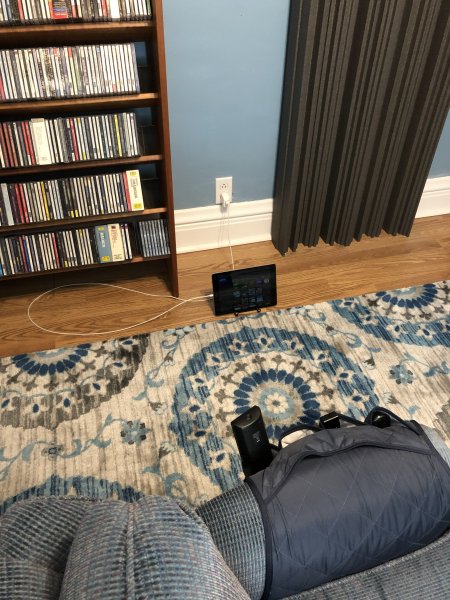

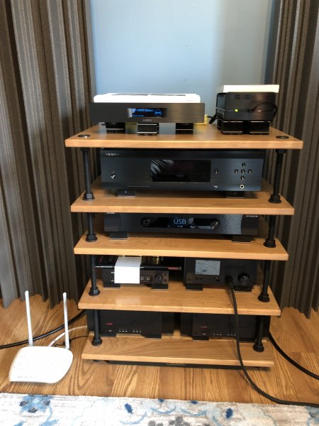

The only hitches I had in my set up of the Lumin U1 mini involved the stability of the internet radio function, which I use a lot. Using the Lumin app on my iPhone X, I had problems with many stations losing connectivity after a few minutes--including my favorite classical station, WFMT from Chicago. Other stations were fine for hours. I was always able to instantly restore the sound of any problematic station by just selecting the same station again, but I wasn't about to settle for that. This was never a problem with internet radio streaming via the Auralic Aries G2, by the way.
Experimenting, I determined that when the unit is controlled by the Lumin app residing on an old iPad I had, the internet radio was totally stable on the problematic stations. I thus decided to buy a new iPad 6th edition (9.5" screen, not the Pro or Air models) which Best Buy had on sale for $250 (WiFi only, 32 gig). You rarely see current Apple stuff on sale and this was a substantial discount from the regular $329 price. Since this new iPad is totally dedicated to controlling the Lumin, I took off all unneeded apps and installed only the apps I use for streaming. Plus, via the Settings menu, I turned off all unneeded functions (a boatload—it takes a while to search all the menus and submenus to find all the settings which can be adjusted to turn off unneeded functionality) just to keep the iPad processor as "unbusy" as possible. This iPad controller works wonderfully and seems totally stable with all internet radio and other functions so far.
Part of the now-rock-solid stability is also related to installing the $25 TP-Link Wireless N300 2T2R Access Point which Upscale Audio recommended as a means of providing the Lumin U1 Mini with a wired ethernet internet connection. Unlike the Auralic Aries G2, none of the Lumin streamers are inherently WiFi capable.
Since I don't have an ethernet connection available in my audio room, the TP Link device is set up in Client Mode to feed the Lumin. In Client Mode the TP-Link doesn't broadcast or extend your router's Wi-Fi. It just receives your router's Wi-Fi signal and provides a wired ethernet connection to devices which are not inherently Wi-Fi capable from its RJ-45 ethernet port on the back of the TP-Link device. After determining a strong Wi-Fi reception spot near my equipment rack, I placed the TP-Link in that spot on the floor next to my equipment rack. From there the TP-Link grabs the WiFi signal from my Xfinity Advanced Gateway and feeds it via a few feet of CAT7 cable to the ethernet connection of the Lumin. The set up of the TP Link is super simple once you see it demonstrated on video (ignore the overly complex user manual!) and takes at most five minutes.
I had been using an old Apple Airport Express in Client Mode mounted in the same spot to provide internet to the Lumin. That was okay once I had the new iPad, but very occasionally there were momentary hiccups. The TP-Link seems to provide an absolutely stable signal to the Lumin; there have been no dropouts at all.
While some may object that this TP Link device only works on the 2.4 GHz WiFi band and not the speedier 5 GHz band, Upscale claims they tested this device in their store and it seems totally comfortable streaming even DSD 512 material to a Lumin device. Remember that the Lumin is the only device served by the TP-Link set up in Client Mode. And since I'm dealing only with at most 192/24 PCM, I'm sure the TP Link's bandwidth is adequate. If it were not, I would not have the rock-solid stability of connection I now have.
The TP Link uses a 9-volt wall wart switch mode power transformer. The cable on that transformer is not quite long enough to reach my UberBUSS from the good WiFi reception spot where I placed the TP Link without running the power cord in a visible manner. I thus purchased and installed an aftermarket 9-volt iPower power supply from iFi, one having both a much longer cord and claiming to be much quieter in terms of electrical noise.
I have a two-meter Apple charging cord and 12-volt Apple charger that can reach from a wall outlet to my listening seat so that I can always keep the iPad at full charge despite having the screen on all the time and often continuously streaming music via AirPlay to the Lumin. When not in hand-held use, the dedicated iPad sits on a little stand on the floor near the wall just beyond the carpeted area of the room, just a few feet from and in line of sight of the TP-Link and Lumin. This keeps the charging cord from being a trip hazard when entering the room and keeps the Wi-Fi connection from the iPad to the TP-Link and Lumin strong. Sometimes I leave the charging cord connected while listening and handling the iPad; other times I disconnect it first. I hear no appreciable sonic difference between these two conditions even when streaming music from the iPad via AirPlay to the Lumin. Running the Speed Test by Ookla on the iPad, the iPad tests at about 500 mbps download, 40 mbps upload from either its stand position or from the listening chair via my Comcast Gigabit internet service. Thus, the iPad is not a bottleneck in the streaming path in any way since its 5 GHz connection download speed exceeds the 2.4 GHz 300 mbps capability of the TP-Link.

The idea is to put the TP Link into client mode. Once the TP Link is in client mode, you run an ethernet cable from it to the Lumin and the Lumin should connect. This has worked first time for me with both the U1 Mini and the Lumin X1 I'm now using. The exact model of TP Link I use and the video instructions for doing this are linked to from the following two paragraphs from post # 3 above which I've cut and pasted below. Just remember that you want to choose client mode when setting up the TP Link, rather than the access point set up shown in the video. The client mode set up is even simpler than that shown in the video since you don't need to set up a new password for accessing the TP Link via Wi-Fi. The TP Link just accesses you existing home network via your existing Wi-Fi password and then the Lumin accesses your home network via its ethernet connection to the TP Link:

Thank you for the quick reply.
I did that and I have the same TP Link 300.
First, I connected TP Link to the laptop by cable and turned off wifi on the laptop. The computer has detected TP Link. I logged in to TP Link settings, chose client mode and the laptop connected to my Netgear router. The laptop has connected to the internet.
Next, I disconnected Tp Link from the laptop and connected to Lumin D2. He did not connect. There was a network error on the board.

I'm not sure I can diagnose the problem from afar. The only thing missing in your description is turning your laptop's Wi-Fi connection back on. Assuming the Lumin is trying to access a music library on your laptop, that might have created this issue.
Assuming the TP Link is now set up properly in client mode, try connecting a computer (with the computer's Wi-Fi capability turned off) to the TP Link via its ethernet connection to see if the TP Link is actually grabbing a Wi-Fi signal and feeding it out its ethernet connection to the connected computer. If the connected computer can't access the internet via the TP Link ethernet connection, you know the problem is not with the Lumin, but with the TP Link. You could then factory reset the TP Link and redo the set up of the TP Link into client mode.
If you continue to have problems, I'd suggest contacting a dealer who uses or recommends using the TP Link device to connect the Lumin to the internet. Upscale Audio is one such dealer. Or, you could pose the question to Wklie (product developer for Lumin) over on the Lumin forum.
Sorry I have no better advice. As I mentioned, I did not encounter any problems in my set up and it took at most five minutes. The connection between the TP Link and Lumin machines has been rock solid for many months since with no audio problems. The only times I've temporarily lost connectivity have been related to area-wide Comcast internet service outages or when I've intentionally rebooted my Xfinity Advanced Gateway router.

Tp Link had a connection problem. I had to do Quick Start again. Now, when I connect it to a laptop, it connects to the router without any problem. Maybe it's a matter of my router? I have to check with another. Thank you!
