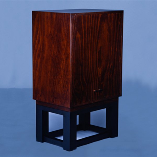

I got the speaker stands today and while the height is better, the overall tonality is worse when using them. The stands are maple and sit directing on a tile floor (with speakers on top of them) and it colors the mid/low registers a decent amount. Definitely noticeable. The stands are ready made for spikes which I might try. Maybe Dynamat somewhere on the top platform that the bottom of the speakers rest on? I tried Herbies decoupling dots, under the speakers (on the top platform) and they made everything significantly worse. Clearly there's something with the maple being directly on tile floor, or the distance itself from bottom of speaker to floor (14") that is creating an unwanted resonance in the upper bass/lower mid. The speaker IS made to sit on a stand. I just didn't buy them from China because they're pretty heavy (steel) and would have been crazy expensive to ship. Any ideas greatly appreciated.
I find it's often one step forward , two steps back with audio...

I would try spikes. That should be a noticeable improvement. Between the stand and a speaker, you can try cork, vibration isolation rubber, or another set of spikes. For me, spikes are mandatory with any speakers.

I got GAIA Acoustic Isolators today that screw into the base of the speakers. They helped a little. On a scale of 1-10 I'd say 3-4 but that's all.
So here we are:
1) Speakers on maple stands sitting on tile. No good, Resonances sound like they're upper bass-very low mid, male voices in particular sound ragged.
2) Speakers on maple stands with GAIA feet (1/4" thread). A little better. Still sound like vocalists are singing into a megaphone but not as bad as stands directly on tile.
3) Just for sh*ts and grins. I take speakers off stands. Nail in little plastic feet to bottom of speakers again that were removed so they could sit on stands. Put them back in place. Much, much better. Of course now the coax horn is about 18" off the floor but they sound 'right' again.
One would think the issue is the stands, no? What could it be with the stands? Maple coloration? Fact that the speaker bottom is in fact a riser (about 1.25" high and 2" thick all along the 4 sides so a gap between the bottom of the cabinet and the floor? LM makes stands for these. They look like steel but they wanted $1000 for the stands and the dealer I worked with, Grant Fidelity, felt the cost of air shipping the stands could be as much as the stands themselves. Given that shipping for the two speakers and the LM preamp alone was $3,400 by DHL I was obviously reluctant to buy the stands. In fact, Rachel recommended I didn't. Two pictures of the speakers on the stands below.

It might be how high the driver is relative to your ears.
Speakers on stands - around your ear level
Speakers on stands with GAIA feet - a slight difference in height
Speakers on the floor - big off-angle axis
Speakers on stands and on plastic feet - off-axis, higher than just on stands.
Speakers off-axis usually experience a roll-off in high frequency. This might negate some peaking in the speakers' response explaining, why sitting in front of it sounds bad.
