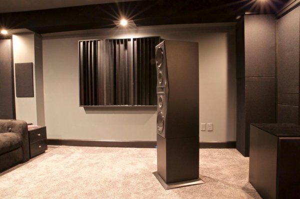

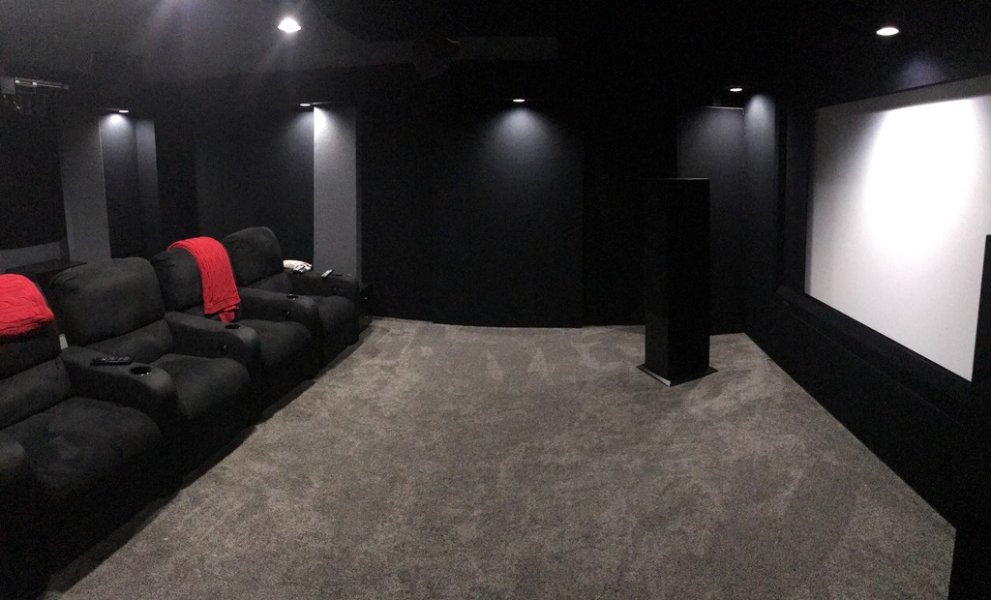

I just made some large cosmetic changes in my room, and changing from 2700K to 5000K (LEDs) was the most dramatic (and positive - even my wife likes them a lot). Here is a before and after photo of the lighting changes as well as the cosmetic changes. As far as LED's causing hum if dimmed - some do and some don't. I used the trial and error approach since what might hum in my room won't in your room.
Old Look: (The colors in this photo are not accurate. Much warmer than reality)
New Look: (All room treatment is still the same but has been covered with black GOM - and the colors in this room are very close to accurate)
FWIW, n my last two rooms, both of which were multi-purpose (music and HT), I had hard wood flooring for the first 7 feet, then carpet. In this room, I chose not to do that ........ but can't remember why (comes with the whole aging thing I guess).
