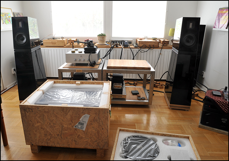

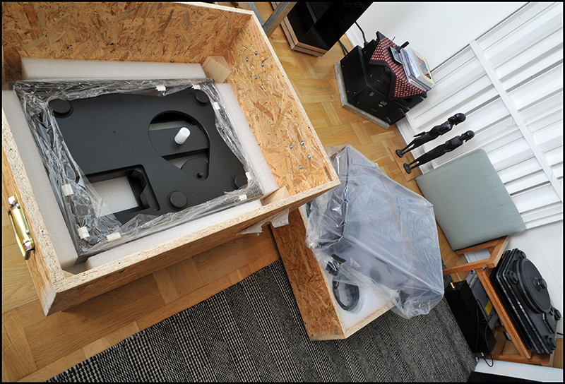

The outer frame and sub-chassis is assembled from the factory.
The outer frame has three feet and the two in fron are adjustable, to make also the outer frame in level.
There are four decoupling towers in the outer frame, of which three are positioned above the feet. The sub-chassis is assembled on these towers.
Detailed levelling is made on the four knobs on the upper surface of the sub-chassis (like for Stabi Ref).
The decoupling is heavy and inert, but should be classified as suspended. I need to press with both hands to even see it move.

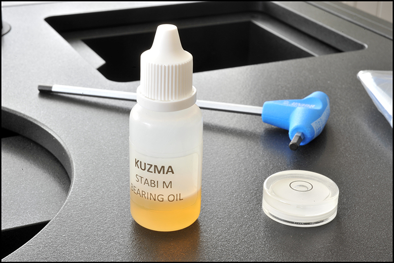

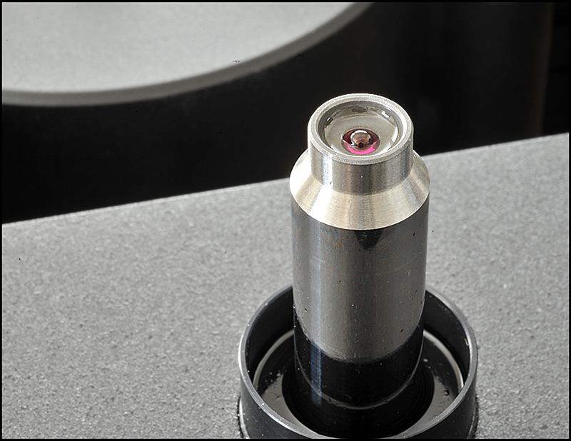

When the protecting knob is removed, I see the shaft for inverted bearing with the ruby ball in a cup :eek:
8-10 drops of bearing oil on the ruby tip and the rest on the shaft. Excessive oil drains to the reservoir (scrotum) in the bottom. So, no risk for overdose;
I remember some teacher saying diamond was the only thing that could etch ruby, and I'm not going to put my diamonds in that cup.

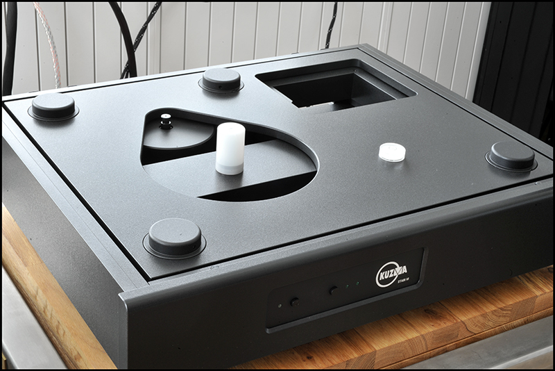

The structure with the sub-platter is similar to Stabi Ref, but the design is slightly altered from a conical interface to a cylindrical.
The only advantage with that (I can think of) is that it's easier to get closer tolerances with cylindrical surfaces.
The flat rim is very stiff, but no problem to assemble over the motor wheel and sub-platter;

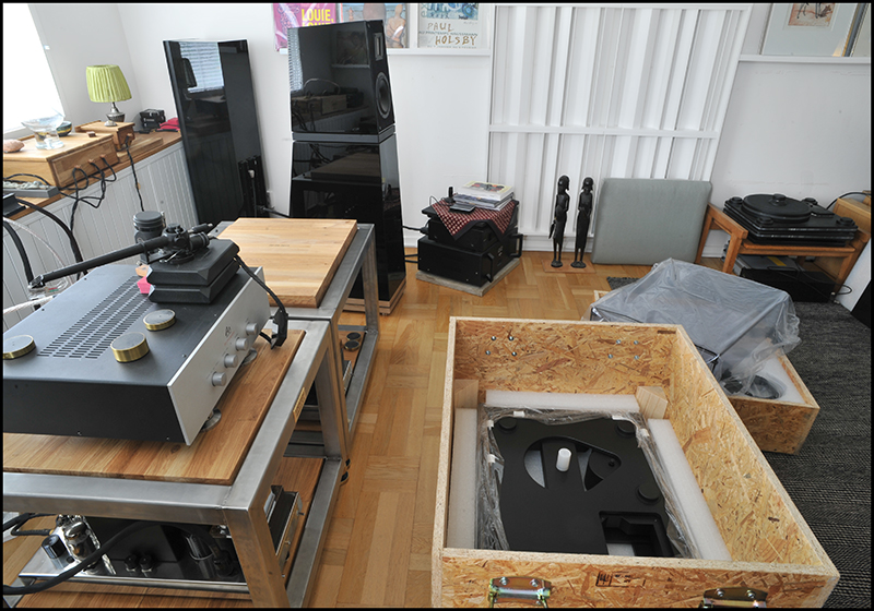

The armboard is grotesque. Very plain but 40mm thick massive aluminum.
The hole for the armboard in the sub-chassis is quite big to accomodate for various arm types, but I would not recommend to drill at home. Even if most arms are fitted with protractor, you dont want a gap in the hole and certainly not a non-vertical drilling.
Kuzma has all possible armboard types, and this one is Linn based but with the 40mm hole ("Kuzma style").

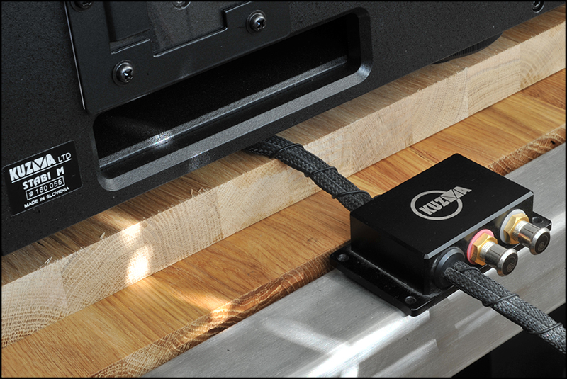

There's a slit in the armboard for the tonearm cables. The weight of the cables does not affect the tonearm as the connection box is fastened to the vta tower.
When 4Point is moved/transported, the connection box shall be moved to other tap on the tonearm housing, avoiding stress on the thin tonearm cables.

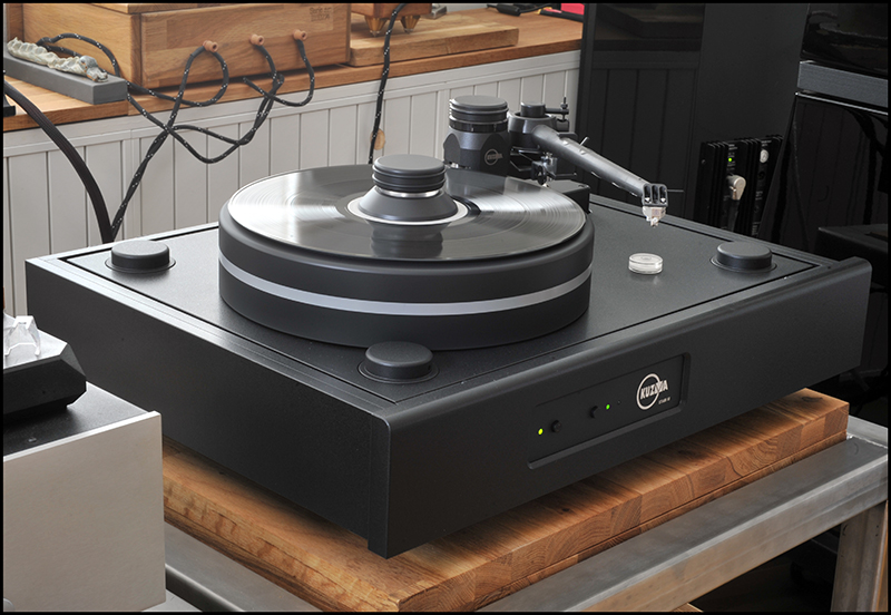

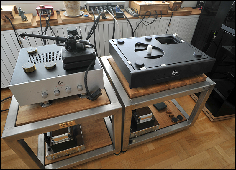

As the arm is mounted, it's time to connect the motor control.
The motor control generates a sinewave to a 3-phase frequency controlled dc motor by an advanced circuit.
I never cared too much about speed, and I think it's not so sensitive as to +/- some %. A constant speed however, that's important.
There's a 7-pole contact for the motor, and a 5-pole contact for the front panel control switches.
Motor control with start/stop, speed 33/45 and adjustment and storing of preferred speeds;
The front panel has the same functions for start/stop and 33/45;
