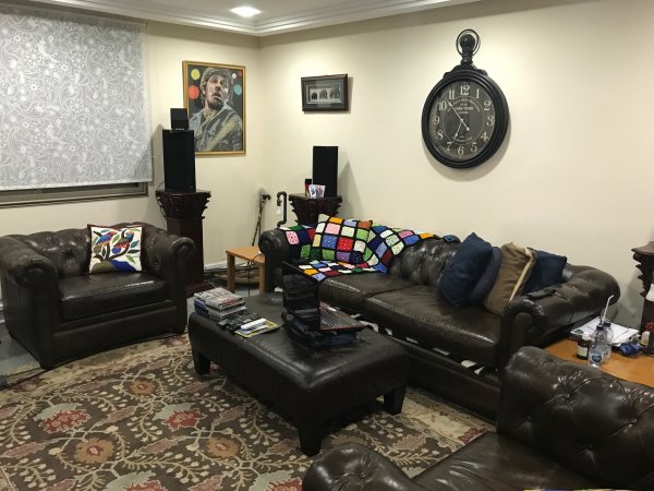

Congrats on saving up. And good that you will be paying cash.
I could not help but notice that your room is all hard surfaces (concrete, tile, gypsum board). You may want to consider using some of the money you have allocated for speakers to some passive room treatment. Even if your Onkyo has some room correction ability, it can't fix that much reflection very effectively.

Thank you for the advice, Unfortunately I can't do any changes on the Apartments as it is on lease. Once I get my own house, then I will be able to build the HT room from scratch. I Thought I could improve my Fronts and Center as they have to match in terms of tonality as my DT BP2006TL Fronts are no match to the rest of my setup. If you've noticed from my setup, The Definitive Technolgy Fronts, Center and Surrounds are all powered and along with the SuperCube I are a bit too much bass to my liking.

I'm not suggesting anything permanent. Rugs on the floor; removable panels you hang on the walls. And, you will be able to use the panels in your home. I can't stress enough how critical room treatment is to getting good sound. Even if you end up purchasing less expensive speakers so that you have funds to pay for the treatments, you will be way ahead sonically. WAY AHEAD !!!!!
Check out GIK Acoustics. They are reasonably priced and very effective.

I take your point and I'll see what can be done and good sound should be the priority, so if I manage to do these changes, any recommendation in terms of speakers and sub based on the options on offer. I'm attaching pictures from my room setup and any additional comments are most appreciated. IMG_0015.JPG IMG_0016.JPG IMG_0019.JPG IMG_0020.JPG

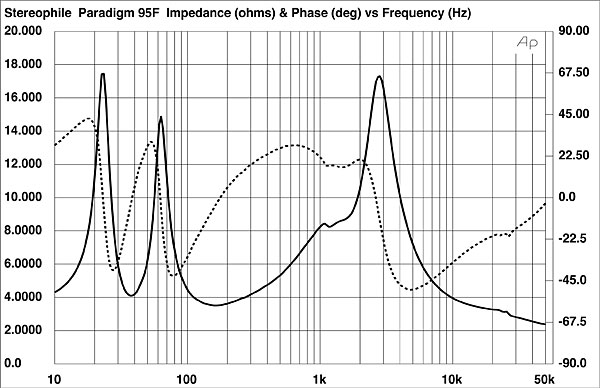

Your Paradigm speakers look real nice: https://www.paradigm.com/products-current/type=tower/model=prestige-95f/page=overview
- https://www.paradigm.com/products-current/type=center/model=prestige-55c/page=overview
• Specs (95F): https://www.paradigm.com/products-current/type=tower/model=prestige-95f/page=specs
• Specs (55C): https://www.paradigm.com/products-current/type=center/model=prestige-55c/page=specs
Have you ever giving any thoughts on separates? Like from Yamaha, or Anthem, or Integra, or Marantz.
Your speakers deserve top amplification IMO, and separates with XLR connections is one way to look @ it, or a separate stereo amp just to power your two front flankers. ...From the front L & R preouts of your Onkyo.
You are using the bass management (two subs are better than just one), in addition to the relative easy load (from the specs) of your Paradigm speakers (with the real measurements in the below post), a flagship receiver like the one you have is fine. And if the volume level you listen @ is not 10dB over reference level (115dB with the LFE channel). ...The size of your room, the respect to your ears and siblings, ...your lifestyle...all look good to me. Enjoy your three new speakers.
