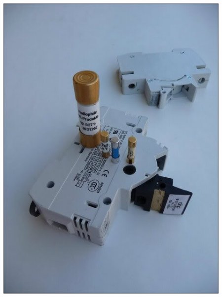

I'm using an AHP fuse in the live siince many years ago, better than usual magnet-thermic disyuntors. Would you let me know if the Gigawatt G-C20A or G-C16A could outperform it?
I'm considering try it too....
I've replace the fuse some years ago after melt it.

I used to use a Siemens Sitor 690V/32A rated fuseholder similar to your AHP before moving to blade type fuses, those are rated for 690V/160A max but you can get 16A fuses for them. I’m pretty sure I was violating code with those

They are typically used for heavy gauge cable short protection to avoid fire, they blow VERY slow. It is similar to the open fuse photo you posted above but it is a silver plated solid copper bar which is rated for 160A. They drill holes in that which are filled with Tin. When its shorted, the bar heats up, the Tin melts and it breaks. So you have no significant losses over it until it heats up to much. This would take much to long to blow for general domestic safety protection.
