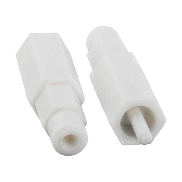

Some have postulated that some of the benefits experienced by "new" cables may in fact be caused by the cleaning effect of merely "breaking" the connection ans installing the new cable. Nevertheless there is definitely a benefit form cleaning the connection. If you still use RCA plugs you will definitely find these helpful.
They aer available at Music Direct for a modest price. You will also need some type of connection cleaning fluid. I guard against Isopropyl alcohol.http://www.musicdirect.com/p-9658-signet-rca-cleaning-tool-ea.aspx

Good product. Get's to places you can't normally reach. And you can clearly "see" the results.
Got mine through Music Direct if I recall.

Hello Amir, this and Caig Deoxit work wonders. I usually do a yearly breakdown of the entire rig for connection cleaning. On my system, the results are easily heard. On a system that hasn't been cleaned in a long time, the results can, as mentioned, be seen. Highly recommended.

I've once used those cleaning plugs decades ago; a word of caution ... depending on rca type, be careful when turn/twisting em, they can really grip the inner female which could twist the inner sleeve/wires attached to the rca. I've seen this happen on a few occasions.

I've had "high end" plugs so tight that I was afraid of damaging an amp removing them. Give me the old school solution: Deoxit whenever plugs are pulled for some reason, and a plug that fits, not a vice grip. that can be turned about 1/8th of a turn back and forth every now and then. Works just fine.

If only there were a similar device for XLRs. I have this RCA device, which I think came with a Caig DeOxIt Kit years ago. But, I now have only XLRs on the interconnects in my audio path.
I guess the only thing for XLR females is a pipe cleaner.
As far as stunning differences go, I have yet to hear one. But, I "feel" better after the cleaning process, and it cannot hurt if done properly. But, then again, maybe increasing contact oxidation (on gold or rhodium which do not oxidize) is part of the improvement routinely heard in the "break in" process, belabored in another thread here.

You might want to to try this advertising trick. Perform your normal cleaning retuine. Thin use the tools. As stated above results are visible.
esp those locking ground types, often brutal to remove, esp if torqued tight (they just need to be snug) Not my favorite rca's, although I still use em in certain situations where a tight connection is required based on non sonic issues.
