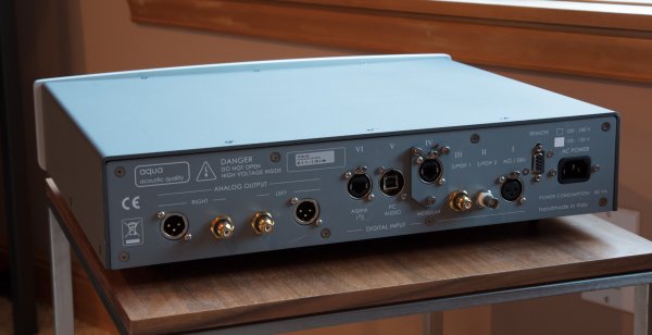

Hmm... Could you then please tell me what this input numbered IV and named MODULAR is supposed to be? I just assumed it was Ethernet, hehe. :)
http://www.aquahifi.com/formula.html
You can see it on the back side here.
Also, regarding the FPGA chip, I believe that they don't offer free upgrades like PS Audio, or am I wrong about this one too?
The MODULAR input is not Ethernet.
As per datasheet, the Modular socket can be:
- AES/EBU balanced 110 Ohm - 24 bit / 192kHz - DSD64
- RCA coax (S/PDIF) 75 Ohm - 24 bit / 192kHz - DSD64
- AT&T (ST Fiber) - 24 bit / 192kHz - DSD64
- Optical TOSLINK - 24 bit / 96kHz
In the picture it's the 3rd option.
Ah, got it! Yes, that makes sense. You can pick your own input to be set when it comes out of the factory. Thanks for clearing that up bibo.
here is a picture of the rear of the Formula I sold 3 weeks ago.
here is what the manual shows for inputs, nothing about Ethernet; it appears to need a server.
can't say what IV does.
