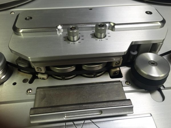

Now for some good news: :cool:
Azimuth adjusters installed, Studer A-820/2CH, 1/4" head assembly
Sam, don't like the look of that tape!!
OTOH, you have to admit that tape does sound great! Your Studer is really the best source component..:cool:
Even with LP's, we still occasionally get bum copies. Luckily the vendors I typically do business with have great return policies.
