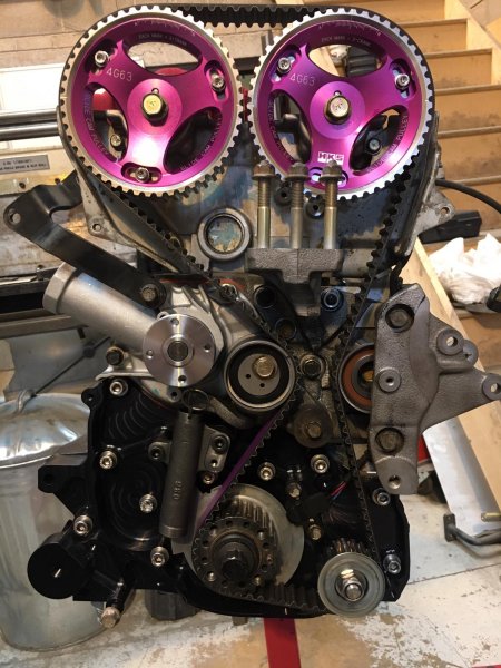

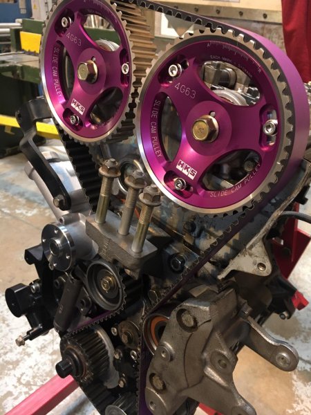

6ec7dd5d-05f4-46b1-aba6-31c8dddeebc2.JPG 1fe69546-5193-4ce1-9361-0ba6d70c89c0.JPG
Reactions: GMKF
infinitely baffled
Jul 2, 2015
1,259
387
340
Scotland
I bloody hope not!:)
Edit
I believe it's made of kevlar
