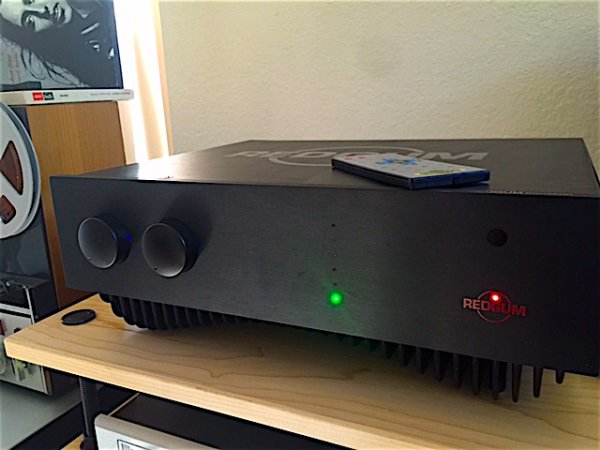

Got your attention?
I received an email last month from Marc Phillips at Coleen Cardas Imports, the folks who import and distribute Opera speakers, Unison Research electronics, saying he had an integrated amplifier that could drive ANY speaker, and even had power ratings specified at 2 Ohms. I was all ears since I had two Magnepan speakers in house.
He was taking about the new Redgum Black series amps, out of Australia.
The 65wpc RGi 35 ENR ($2500), the 125wpc RGi 60 ENR ($3500) and the 175wpc RGi 120 ENR ($4500)
Marc shipped me the RGi 35 ENR, which puts out a published 90 wpc into 2 Ohms, for a formal review!
Well, I hear a lot of importer sales pitches, but Marc was not kidding. This amp is amazing. It has a passive input stage,
5 inputs, independent R/L volume controls, and it is indeed black!
http://www.redgumaudio.com/product-category/black-series-amplifiers/
CCI, is now the importer of record, and should be receiving stock soon.
