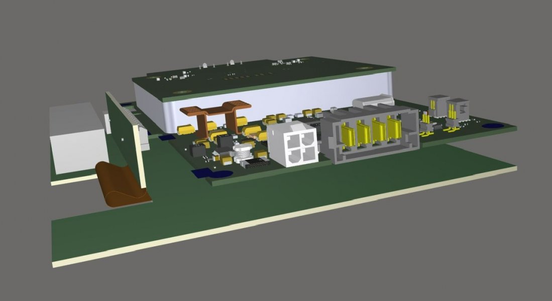

The intended product will be modular and offer either Digital or Analog outputs. With the former, you can specify "standard" digital interface formats that still allow the use of any DAC and upsampler you like. You can also specify the new Taiko interface format which will limit the connectivity to manufacturers that have also implemented this new format. The analog-output DAC version, finally, is a closed system.
The Modular Daughter Board will provide one specific function from an array of options such as:
1. A DAC with Analog output
2. Generic S/PDIF, AES/EBU, I2s, or other digital formats
3. Custom output like MSB Pro ISL or Dual AES/EBU for DCS
4. New Taiko proprietary interface

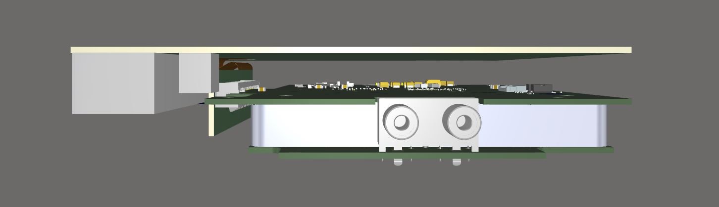

As for the modular design, a few renders may help clarifying:
The “white block” is a solid machined piece of copper which contains and shields the optional output modules which in turn plug into the interface carrier board. In this render it contains the analogue output module.
