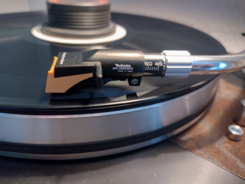

- Technics EPC-205C mk3 - worth tracking down for relatively little money. Excellent refined and well extended on top and bottom end. Slams like a MM should with 75% of a good MC resolution and air. Better than modern Nagaoka up to and including MP-500. Jico make an excellent MR + solid boron rod stylus replacement that gets you 75+% of the way there to an original retipped stylus. If you can track down an unmolested example with intact boron hollow pipe cantilever (not solid rod) that is not filled with crud from prior wet stylus cleaning and get it retipped to a MR stylus you have a nearly top of the line MM.

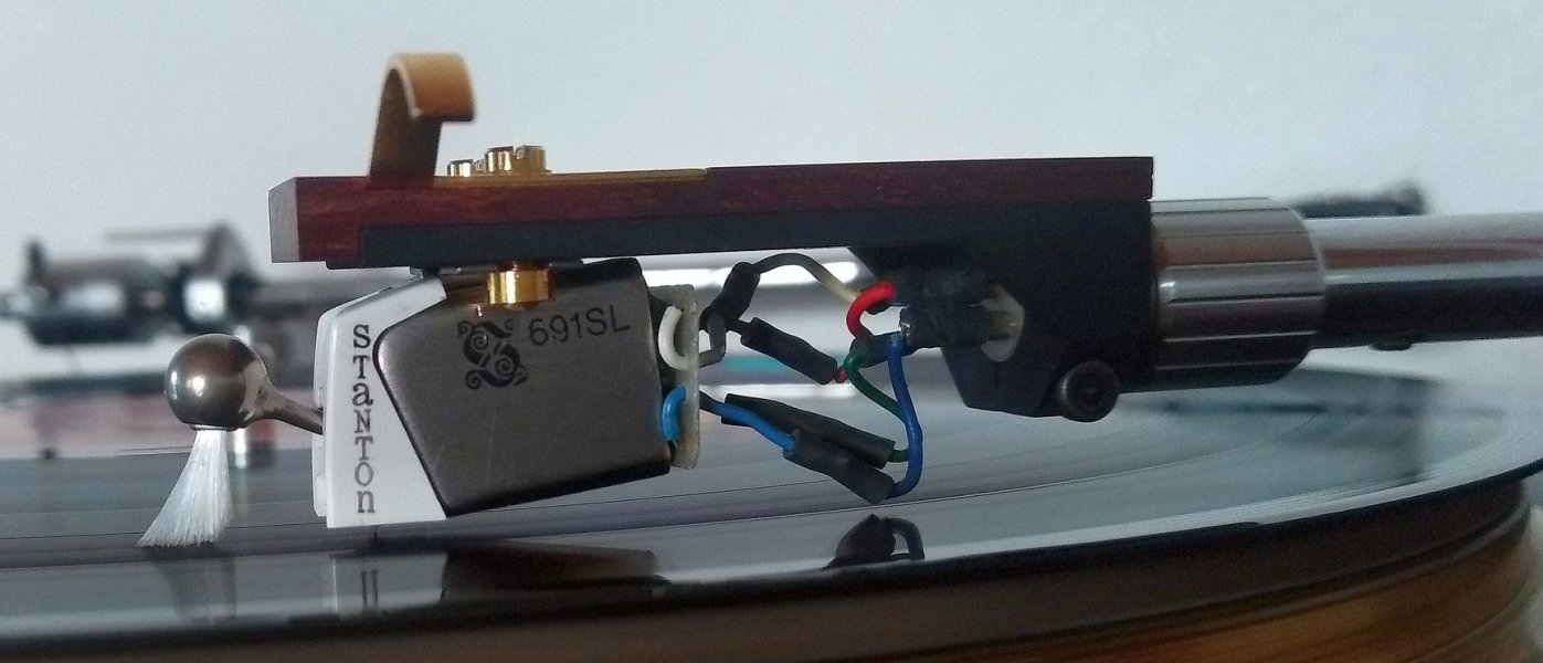

There is quite a lot of good vintage MI/ MM cartridges worthwile collecting an playing occasionally. But you need suitable tonearms and matching phonostages, allowing many load setttings up to 400µF and up to 100KΩ.
Here an example:
(Stanton 691SL)
