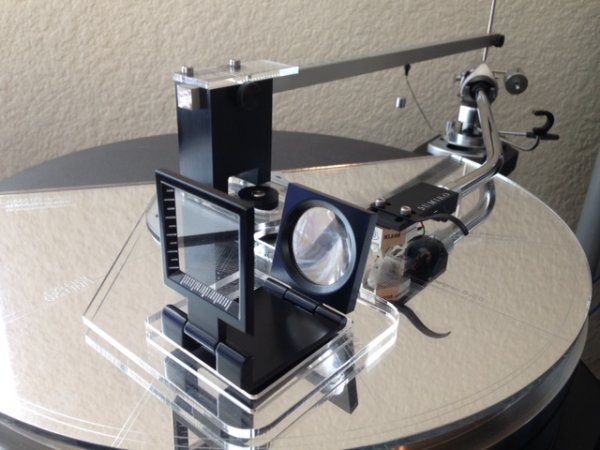

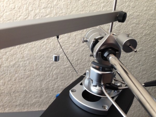

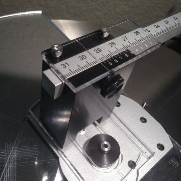

SmarTractor at work
Here as promised are some pics of the SmarTractor in use.
David Karmeli convinced me to try an SME 3012-R and I was so impressed with the arm's performance I bought a second one..........David is going to send me to the poorhouse!
Thanks David you were absolutely correct in your assessment of the 3012-R, no wonder you own twenty of them.
As you can see the SmarTractor is fairly easy to use and provides five different alignments including Uni-Den which is propriety, I shall be experimenting with this alignment soon.
I stand by my statement that this is by far the most accurate protractor I have used, a bit expensive but well worth it if you consider what went into making it. Not unreasonable when you consider the cost of cartridge, arm and table.
After all we are using performance products and everything has to be optimized.
The pivot point is fairly easy to obtain on the SME if you mark the center of the top the yoke on the tonearm, when you get there rotate the arm and if the marker stays on center you are there.
A word of caution, be sure to lock the platter when you are making alignments to avoid any accidents.
Jam
