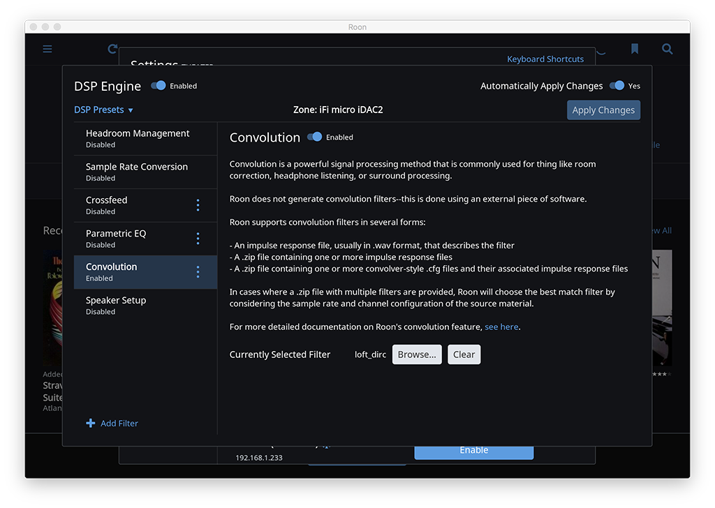

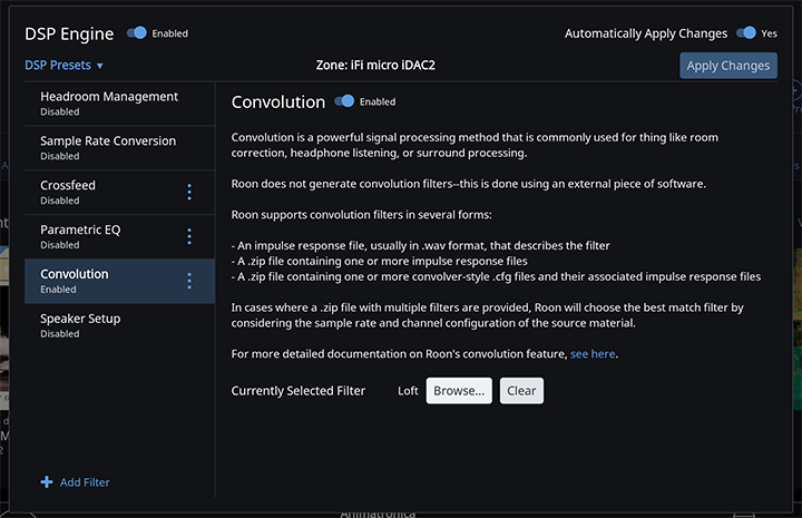

Here's a zip file of the .cfg files that I'm currently using:
I've removed the filter files, so when you create your .zip file for Roon, be sure also to include these files that are generated by Acourate:
Code:
Cor1S44.wav
Cor1S48.wav
Cor1S88.wav
Cor1S96.wav
Cor1S176.wav
Cor1S192.wav
Cor1S352.wav
Cor1S384.wav
If you generate filters for all sampling rates, the .zip file that you upload to Roon should contain a total of 16 files...eight .cfg and eight .wav.

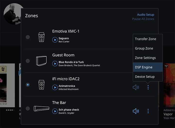

Here's where you upload them in Roon...choose the zone for your listening room and select "DSP Engine" from the pop-up menu:
Navigate to the Convolution tab and upload the .zip file that contains the eight .cfg and eight .wav files:
-- David
