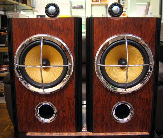

Tim,
The mesh covers are there to preserve my kids' lives. If they poked a diamond tweeter with a nerf dart or something, child protectice services would be after me!
Lee
Lee,
Remember the old B&W Silver Signature's? My children grew in audiophile environment - since they started to walk they were used to go around turntables, cables or speakers laying anywhere. They never broke or damaged anything - except a B&W SS tweeter. When I found the metal tweeter dome pushed in I asked them who did - my 7 year old boy accused himself and explained - my finger get trapped and I could not take it out! If it was not for the protection maybe he would never have damaged it! Anyway B&W were very kind - they sent a new dome free of charge.
