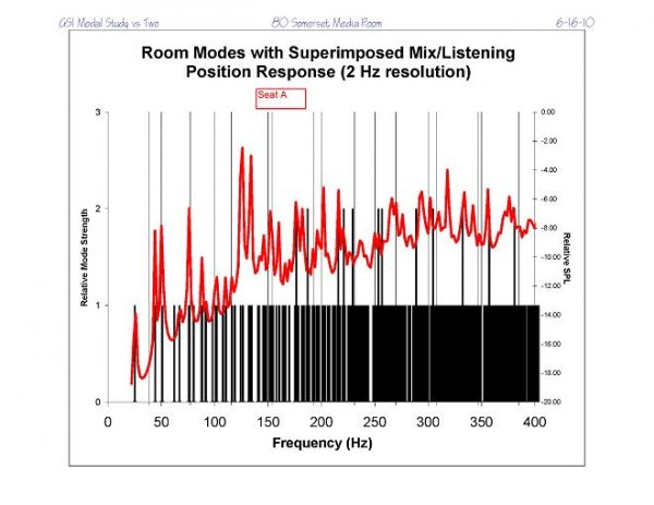

more on the predictive studies
As mentioned, much was predetermined and the seating layout was in that column. Here is an overview with three location studies of my predictive analysis. As the room was fairly "rectangular" in shape and all surfaces were of a relatively hi-mass and isolation type, I did expect these predictive studies to be on target...seems that they were. Nyal and I spoke of the overall effectiveness of this front & back side collaboration and again...it is a pleasure to work with you Nyal.
Note: as these studies are focused on the sub locations (see previously attached pdf), the data above ~100Hz is of little value.

I'm pretty sure that the final seating layout changed slightly from the one shown in the architectural plan view (to nine seats). So, the main listening/viewing position (which is likely the measurement location shown in Nyal's graphs) would be between locations C & D as marked. I'll let Nyal confirm.
Nyal Mellor
Jul 14, 2010
590
4
330
SF Bay Area, CA, USA
Jeff is right, there was a three seater couch used instead of two, although it was about the same size as the one in Jeff's diagram. The measurements shown are from between C&D.
