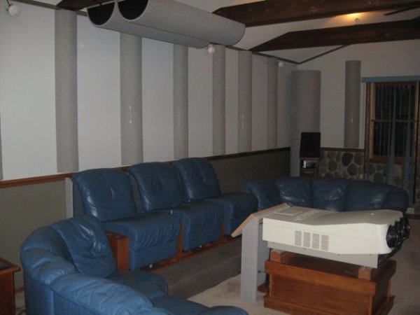

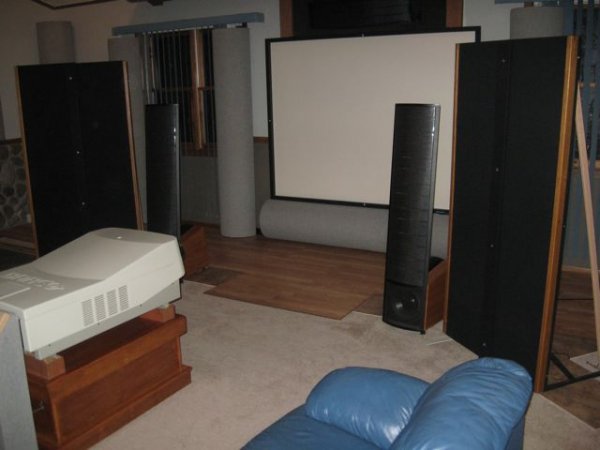

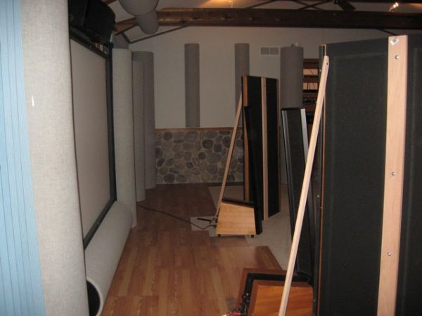

bwraudio
Jan 24, 2011
54
1
ASC Tube traps with dipole speakers
I have Martin Logan Summits along side of Magneplanar Tympani IV bass panels.
ASC tube traps are placed behind these dipole speakers and above on the wall.
The speakers are placed from 6' to 10' from this wall and this large distance
to the wall behind the speakers reduces comb effects considerably. In my
experience with dipole speakers, eliminating the rear wave completely is a big
mistake as it takes all the life out of the sound. I also have hardwood flooring
behind the speakers, as this, in addition to the (great distance) provides a great
feeling of space and the imaging and soundstage is fantastic. The room is
completely treated with 35 ASC tube traps as well as GIK bass traps and other
diffusing devices. Placing ASC mid range tube traps 3' apart around the entire
perimeter of the room provides fantastic imaging and gives one the feeling of
great space. Voice reproduction is very real and easy to understand. Large
bass traps are in all corners from floor to ceiling as well as the midpoints of the
walls. Above the listening area are Large bass traps that also prevents comb
effects. Because of the even spacing of traps, one can walk around the room
and the sound is very uniform and realistic. This room is somewhat similar
to Peter Moncrieffs room of International audio review, which is on ASC's
website.
