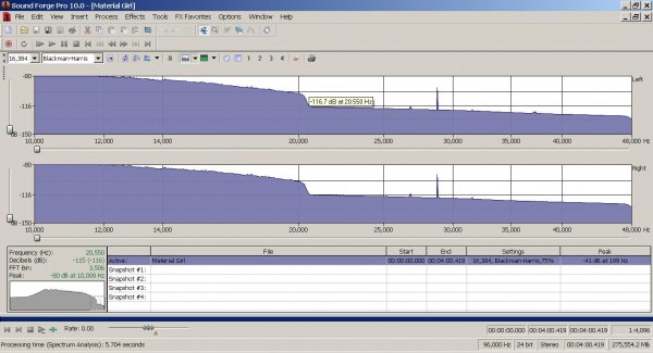

But if you zoom in, you can clearly see the slope ends at 20.5k, well below the Nyquist, which is at 22.05
So... this is actually a 24/96 file that has been filtered from a tape machine.
Fair enough - so no real content above 20K. But what (in your view) is the benefit of a 96k sample rate?
It is also very different from the Holst example I was discussing - where the energy drops to almost nothing just under 24k, and then goes up again, in a pattern looking very much like DSD noise shaping.
Correct....

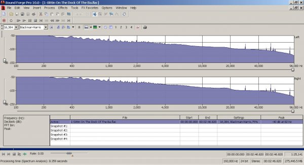

The new Otis Redding - Dock of the Bay

I am here to learn - so, just for my education, how would the spectrum look like if you took some CD (44.1/16) or 48/16 material, and upsampled it in DSD for SACD, and then took that material and converted it to 96/24 PCM? My naive assumption would be that there would be a very steep drop in content at 22 or 24 kHz, and then a softly increasing noise spectrum (from the DSD noise-shaping) above that, again falling when the low-pass filtering for the PCM kicks in.
So, Bruce, what do you think of this spectrum:
I would say it is a DSD file resampled to 96/24, with low pass filtering applied above 32 kHz. Would you agree?
It could be either:
A pure DSD file with steep filtering above 32k
or
A PCM 24/96 file with steep filtering above 32k

It could be either:
or
But if it is a PCM file, it would still have been resampled from something that was in DSD format, judging by that noise shaping?
Yes, forgot to add that:
A PCM 24/96 file upsampled to DSD with steep filtering above 32k
