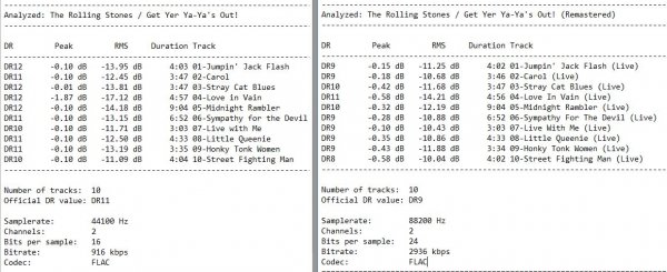

Some quick (and automated) tools provide the following information comparing CDs vs. the High Sampling Rate/Increased bit depth counterpart:
In these cases we seem to have lost dynamics. I have not done a proper ABX testing (Rolling Stones), but I am sure on first listening the SACD would sound “better” because it is louder. Why would any increased bit depth mix loose dynamic range?
Why is there an 88 KHz and a 176 KHz versions of Rolling Stones available? What energies do we think are persevered in the bandwidths between 44 and 90 KHz recorded on tape in the 60’s that actually we believe can be brought forward, amplified by our systems and enjoyed by a human being?
Looks like a different master. So you have not done a proper ABX test though you automatically dismiss the hi-rez. I'm sorry... I haven't learned to listen with my eyes yet.

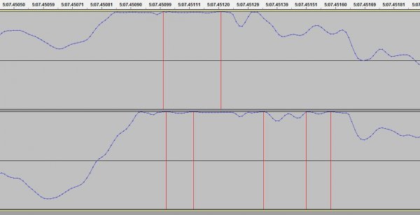

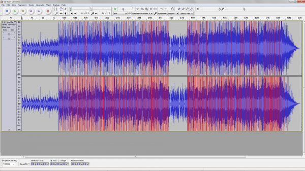

Just so we know what we are talking about, the below is the “hi-rez” version of Hotel California. The red stuff is clipping. I have zoomed in one area to show what that means. This is over-compressed, heavily clipped and distorted music. I feel like an idiot paying for it.
Let’s say that HDTracks can sell whatever they want without caring about the quality and charge an extra $10 just because there are people who will pay for absolutely nothing (e.g. Rolling Stones 88 KHz and a 176KHz offerings) thinking they are somehow getting a better recording.
My suggestion is simply to allow for people who buy music at HDTracks to rate the recordings Amazon style. This would weed out the bad recordings and install confidence in trying new music based on other customers feed-back. If 1 person says a recording is crap then you don’t know, but if 10 people comment then you have a pretty good idea of what you are buying.
HDTracks would benefit from this and I am sure that one day they will introduce it, because it is good customer service and they have nothing to lose. They will sell more. Right now, based on what I purchased (~30 titles) I feel “safer” buying a 44.1/16 old blues recording than an 88 or 176/24 rock album.
View attachment 8092 View attachment 8093
Cheers, boh
You don't need to wait for Hdtracks to do that. The free market is taking care of that for you. All you need to do is go to the places where folks post their findings about files downloaded from Hdtracks. I have stopped buying music from HDtracks. However, I might be convinced to buy again if someone else hits the barbed wire first and posts their graphs.
