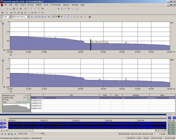

Thought i'd post a file of the Graceland album. What you have to do is to zoom in on where you think the problem area is. You can see the dip actually occurs before 22.05k. If this was an upsampled file, you would see a steeper cutoff at 22.05k and go below -100dB.

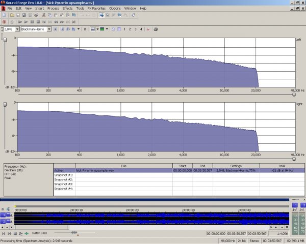

Here is what upsampled files look like. As you can see, they both fall off the chart at -124dB, the theoretical limit of 24bit.
One file has been upsampled with Korg AudioGate and the other file has been upsampled with the Pyramix Apodizing filter.

Now here is what it looks like if you don't zoom in. You can really see a brickwall at 22.05k
This is why when you are looking at spectral graphs, it may become necessary to manipulate the graph and zoom in so you can see what is really happening.

Thank you for the very illustrative graphs. Just for completeness, maybe one that shows how a CD that has been played through a DAC and then a normal analog studio mixer and equalizer chain, and then re-recorded from the analog in 96/24 or 192/24?
