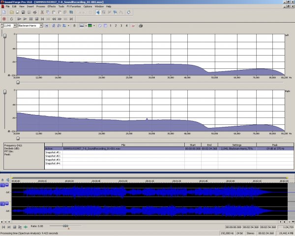

Well you would have to go to PCM to do an FFT. So either way. At some point it was a DSD file.
Indeed - so we seem to be in agreement here. But just to clarify, what do you think of this one - I would think it was something that was originally a 48 kHz sample rate file, that got upconverted to DSD, and then reconverted to PCM?

You would be correct.
Thanks for confirming that - so occasionally we Audacity Cowboys do get things right. I am just a bit confused as to your earlier comment on the same file, where you stated "I would not write it off as some upsampled file... IMO...". I am wondering if it is a semantic issue - do you consider taking a 48 kHz sample rate PCM file, upconverting it to DSD, and then reconverting it to 96 kHz PCM as not being an upsampling?

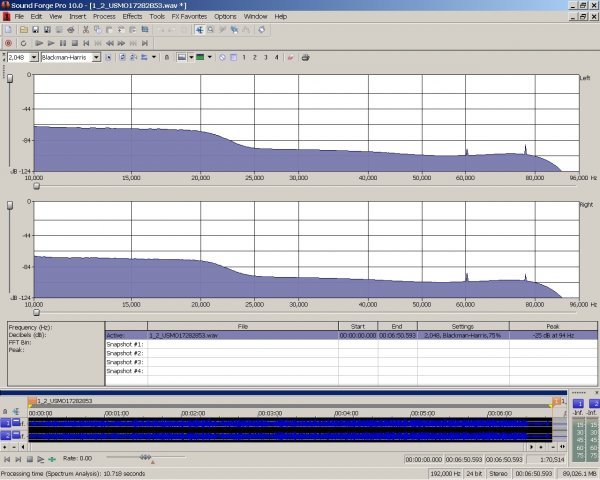

To stop another rumor from HERE..... I'm showing the FFT of the Beach Boys - Pet Sounds which are NOT upsampled files.

OTOH, Bruce, take a look at the SACD of Dire Straits "Alchemy"
But doesn't it look like a conversion from DSD/SACD?
If this was from SACD, you would not see a dip at 45k. You would instead see a steady rise starting at 25k and getting larger from there, with no dips.
Ah, yes. Good point. But doesn't that 45k (or 48k) dip then suggest possible 48k source material?
According to Nyquist, you would assume a 96k source, correct? But even with that, the signal would dip down below the -124dB threshold of 24bit.
I would say it's suspicious at best. I'd certainly would need to do more forensics to rule out everything else.

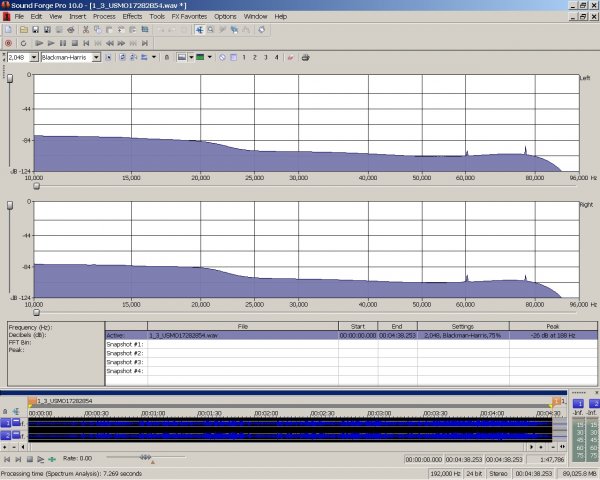

Stevie Wonder - Talking Book...
Someone wanted me to post the FFT so they can "see" how it sounds!!
