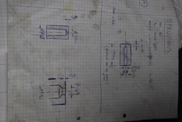

About the "multiple air nozzles" plan (in home made):

Impressive. Can we have a photo of the motor side?
