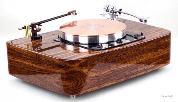

Without hesitation, the Artisan Fidelity Garrard 301 Statement series plinths I would recommend, namely for their tonal characteristics, musicality and open, lively vibrant nature. For comparison, in the past, having used Slate based and various composite based heavy plinths I can attest AF has it right. Over damping in my experience, is a killer of dynamics and life. Did I also mention the high quality finishing? :D
https://www.artisanfidelity.com/gallery-turntables/
About a month ago, I referred an overseas friend of mine over to them for a 301 plinth, and he purchased a Macassar Ebony finished one. Breathtakingly beautiful and even ships in a crate.

+1 on Artisan Fidelity. Thats who I use.

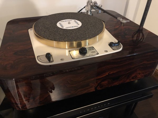

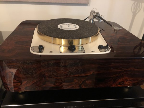

I am very satisfied with my Russ Collinson Layers of Beauty plinth I had custom made. I asked for eight layers of alternating solid cherry and birch ply and specified the same width as my Symposium Foundation Ultra top shelf. I asked for cocobolo veneer and piano lacquer finish. Russ did not select any old veneer. He obtained an unusually striking piece of 1.8mm thick veneer that had to be applied manually with clamps (rather than the more common vacuum bagging used with the more common .6 mm veneer). I specified no arm board/plinth pocket for the arm mount. I wanted the additional rigidity of mounting the arm directly to the plinth. The plinth weighs about 50 lbs. IMG_0379.jpg IMG_0378.jpg The plinth supports a nearly NOS early grease bearing rimless ivory 301. I kept the original grease bearing just in case, but for now I had it professionally replaced with a Peak HiFi (UK) brass main bearing and replaced the original platter with a solid brass slightly oversized custom platter-nearly 30lbs-from Shaun at Peak HiFi as well. That's a VdH Crimson XGW Stradivarius cartridge mounted on a 10.5" Reed 3P.

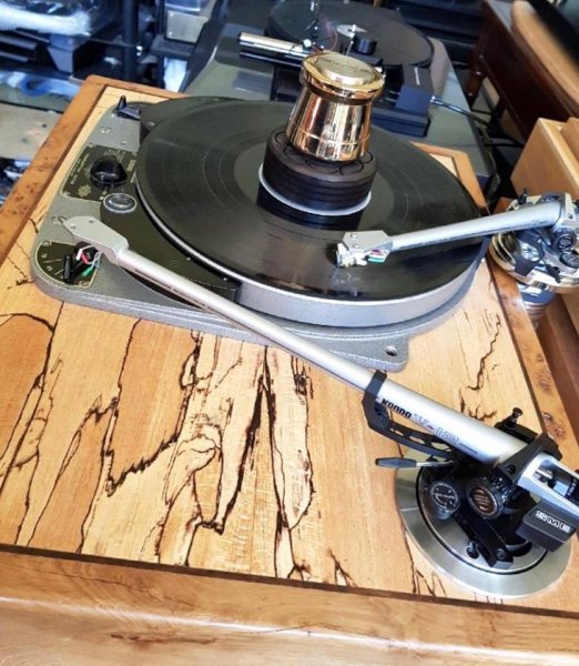

The Cusworth plinths are completely hand crafted, the motor is detached from the chassis and held internally on an inert platform, similarly the arm pod is detached from the top of the plinth and secured on it's own inert pod. The woods used are saw cut (Not veneers)

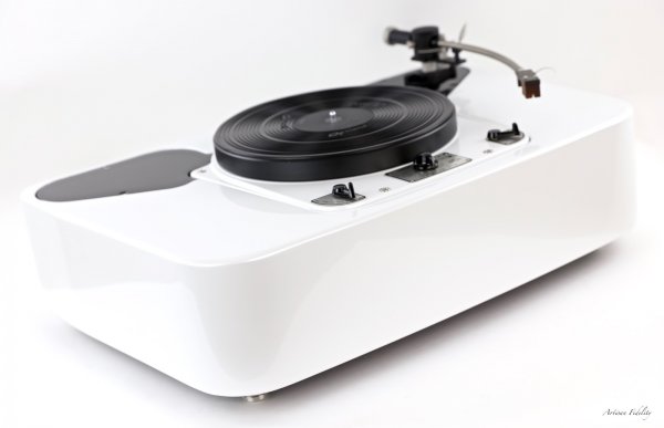

Another AF beauty Audi Pearlescent White

In hindsight, I have always felt perhaps I should have opted for Kingwood instead of a Macassar Ebony finish....... :cool:

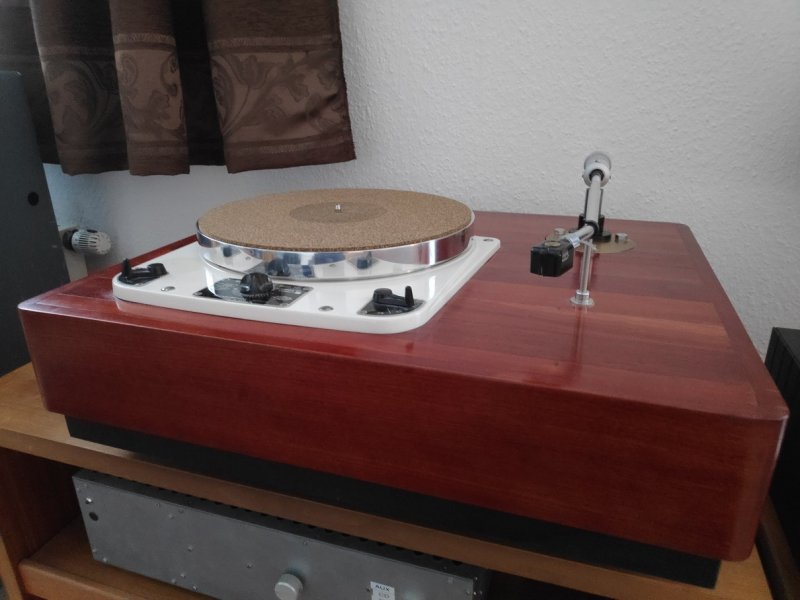

It's made from massive vertical layers of solid cherry wood. That's the best sounding wood for a Garrard plinth.
