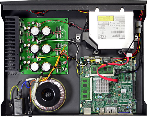

Yes, I have a view about the Mojo server. They use very good power supplies which they make themselves. Industrial low-noise motherboard from a different maker (not supermicro), but also good. Plus the JCAT cards are powered independently. It's a great build. From technical point of view it has an edge over Innuos. Innuos has a nicer enclosure and their software seems very easy to use.

For what it's worth the Mojo server has both a Linux option and JCAT Ethernet Card option. Below is from the Mojo Audio Website:

If it's strictly a music server then I'd go with Mojo Audio. I'd create a bridge connection on the JCAT NET Card - one port for the router (home network) and the other one to connect an Ethernet DAC (Renderer) directly.
