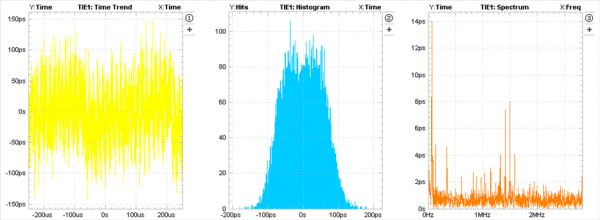

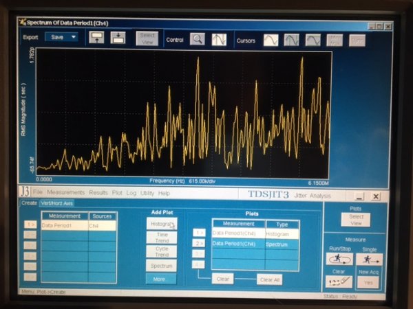

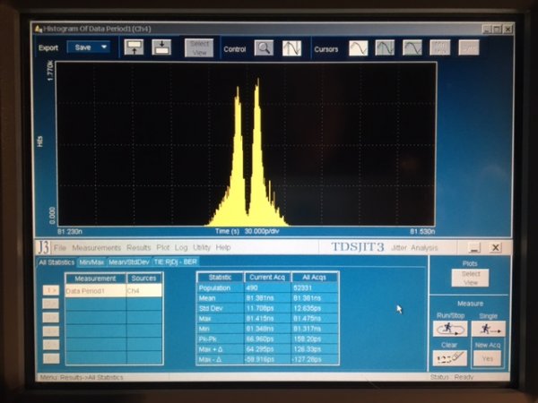

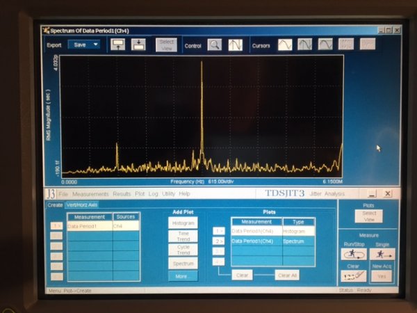

The plots are a distribution of period measurements. There is a nominal period measurement, which would be a single spike in the center if there was no jitter, at a height equal to the total number of sample measurements.
Each spike represents the number of samples of period measurements that were recorded at that particular period. The taller the spike, the larger the number of measurement hits at that particular period.
As for correlation, I spent yesterday with my wife doing listening tests. She was unaware of which cable was in the system.
I updated the link to show the results of these listening tests. In a nutshell, the narrower the overall distribution, the better the rendering of high-frequencies and venue echoes, even with 2 humps. The wider and deeper the soundstage became.
However, I also found that the lifelike quality of the vocals was more related to the cable construction and conductor material. My Bitmeister had one of the best renderings of vocals and just sounded live, and yet it had the widest distribution. It also had a smooth distribution with one hump. 100% silver cable.
OK, from what I can gather this is a TDC, time to digital converter scope/device. Typically these have 45 psec resolution, that is the finest binning.
Although TDCs are not as accurate as Time Interval Error (TIE) measure of jitter - it helps to understand what the plots show by describing how TIEs work?
"The time difference between a real clock and an ideal uniform time scale, after a time interval following perfect synchronization between the clock and the scale. "
That is, the scope is set to collect a huge amount of data points. (10 -200 million points).
Then the run is stopped, and the data edges are searched for. An algorithm looks at the data structure, defines the Unit Interval (UI), and from there recovers the frequency of the fundamental clock embedded in the data.
When this ideal reference fundamental clock is reconstructed then each individual edge is examined again, and the difference between it's actual crossing time & the reference crossing time is what is called TIE.
So, with a TIE plot all transition points perfectly matching up with a reference crossing time would give a spike which consist of a single line with no broadening i.e. all the transitions would be exactly at the right time. Real world clocks are not this accurate so a certain amount of short term (not long term) drift is normal.
The TDC used in Steve's plots are not as accurate as TIE so the 'reference' has at least 45 psec of jitter already in it but the following still appplies
In order of decreasing performance the following plots would apply, I believe
- a single spike with as little broadening of the spike as possible (this also means that the spike will be higher i.e. the number of hits on time will be higher)
- a broader single spike i.e. more hits are off slightly from ideal
- two spikes instead of one spike would imply that there are transition timing errors concentrating around two distinct timings. I'm not uture I follow your explanation for this "The two humps indicates that the driver pulling high has a slightly different output impedance than the drive pulling low." The transitions are either on rising or alternatively, on falling edges b, not on both - or am I wrong here?

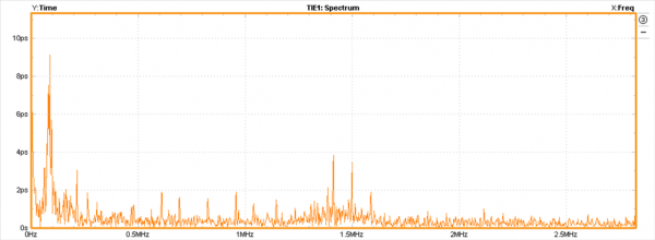

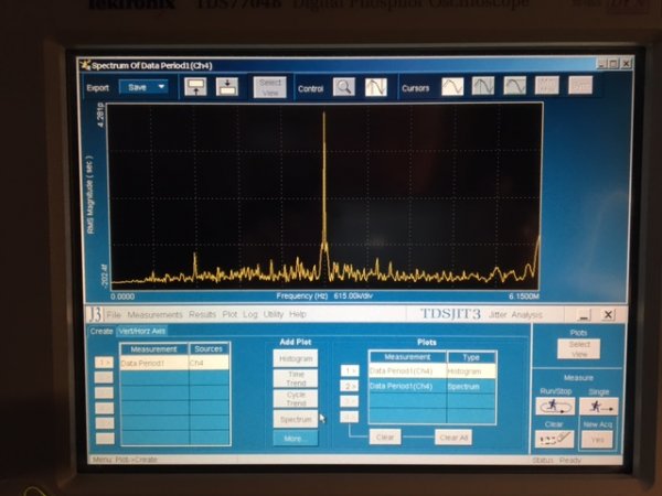

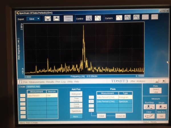

BTW, doing an FFT plot of the TIE is revealing of the frequencies at which the mistimings are occurring.
For instance from the plots in the link I gave plot shows mistimings at low frequency. We have to be careful how to interpret this frequency plot - I believe it's a plot of the statistical distribution of the hits?
For instance here's a TIE plot & FFT of the frequency
or this one
So we see, in this plot, a higher concentration of hits around 1.5MHz but also at low frequencies
So am I correct in thinking that low frequency hits directly relate to low frequency issues, perhaps PS issues or close-in phase noise issues & the spikes around 1.4MHz spike is because the spdif bit rate at 44.1khz is 2.8224 MHz. Half of it is 1.4112 MHz
So, I'm surmising that a perfectly timed signal would result in a spike at the 1.4112 MHz frequency with no side spurs anywhere else?
If that is correct the close in phase noise would be seen as spikes around the 1.4112 MHz frequency or a broadband raise in the area around this frequency

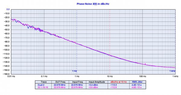

OK, I'm talking about the measurement directly from the output of the oscillator itself before any transmission through SPDIF transmitter or cable
I wondered how using a standard clock Vs 'good' (low close-in phase noise) clock would be seen in these TIE measurements
It wasn't until I got these individually measured clocks that I could definitely confirm the audible effect of clocks with low close-in phase noise - relying on the plots published by manufacturers tends to be a mistake - I'm told they select the best & publish that as the phase noise (if they actually spec phase noise which most don't) - the close-in phase noise range for the clocks that are then actually sold are usually pretty wide
Here's phase noise plots of the selected clocks.
I made a lot of TIE measurements, which I will post tomorrow.
After doing the listening correlation tests, I realized that my rather old poorly measuring Bitmeister cable actually delivers liquid vocals, even though the imaging is not great and my new partial silver cable is lacking in the liquid vocal department. Today, I modded my reference cable to try to remedy this and low-and-behold, it fixed this. It is now more live than ever. I will have to charge more than $275 for it though. I don't like to offer 2 versions, but I may have to. Lots of customers want a $275 cable and anything more will put them off. This is simply the best cable I have ever heard. Customers have sent me their cables to compare and nothing comes close now.
I also went back to my source termination in the Synchro-Mesh and tuned it slightly up and slightly down to see how the cables respond. The undershoot increased in both cases and the two peaks in the plots moved apart more, so I went back to my original termination, which I empirically set based on the 1694A cable. I guess all of these cables are pretty close to 75 ohms. There might be tiny tweak left though, a few ohms.
This work is paying off already.
Steve N.
Empirical Audio
Great! Look forward to seeing them
