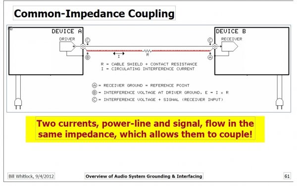

Here's what Whitlock says:
The BIG Problem with Unbalanced
• When two devices, each having its own power cord, are connected by an audio cable, a small power-line current will flow in the audio cable … a fact of life
• Essentially all this current flows in the grounded conductor, typically the “shield” of audio cables
• Since this conductor has resistance, a noise voltage appears over its length … per Ohm’s law
• The noise voltage is directly added to the signal seen at the receiver … just like two batteries in series
Technically, this coupling mechanism is called “common-impedance coupling” because an impedance (resistance) is “common” (shared) to two circuits. One circuit is between device A output and device B input (the signal circuit) and the other is between the AC power connections at each device. In this example, since there are no safety ground connections, the current in the second circuit is due to “leakage current” (which flows from power-line to chassis in each device). The “common impedance” is, of course, the resistance of the grounded conductor (usually, but not always, the shield) in the interconnect cable.

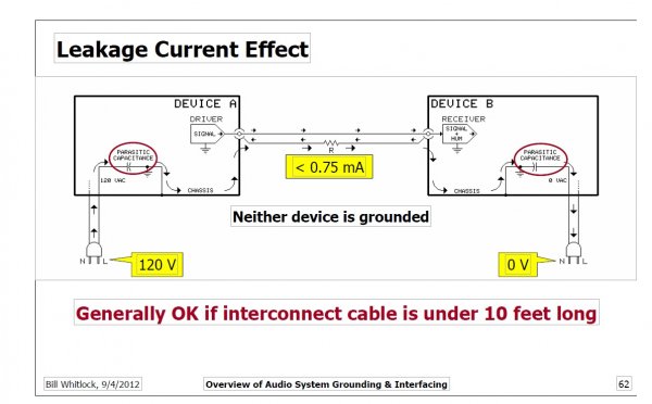

The “parasitic capacitance” in each device causes a small AC current to flow. Just as with a battery, current must flow into a capacitor to increase the voltage across it – or “charge” it. Conversely, current must flow out of a capacitor to decrease the voltage across it – or “discharge” it. Since these capacitors connect to the 120 VAC 60 Hz AC power, the voltage across them is constantly changing and a predictable amount of AC current will flow in the process. For equipment with UL listing and a 2-prong AC power connection, this current can be no higher than 0.75 mA – just enough to cause a slight tingling sensation if it flows in your body. Although harmlessly low, this current can cause enough voltage drop over the length of the signal interconnect cable to add significant “buzz” to the audio. While it’s remotely possible that leakage current could cause a “hum bar” issue in video, this author has never seen or heard of such a case.
Now what Whitlock doesn't say above is that there are always leakage currents (except in battery supply PSes) - it's just a matter of what current level - Typical leakage current limits by application are:
Information technology
Permanently connected – 3.5 mA or more in some applications
Movable or pluggable, not handheld – 3.5mA
Handheld – 0.25 mA
medical grade PS permissible leakage current under normal conditions is 0.5mA and 1mA
Class I Equipment:
Must have a protection against the electric shock by means of a basic insulation in combination with a protective earth ground connected to the equipment case.- maximum leakage current is 0.75 mA for the hand held and 3.5mA for the other equipment.
Class II equipment:
These equipment do not have a protective earth ground. Such equipment uses reinforced or double insulation to provide protection against the electric shocks. Maximum leakage current is 0.25 mA.
Now Whitlock goes on to calculate the reduction in SNR due to half the 0.75mA allowed on a shield resistance of 1 ohm
"• Signal to Noise ratio = 20 x log (316 mV?316 µV) = 60 dB
• This is 35 dB worse than an audio CD!"
Readers can work out what SNR would result from twice this amount of current leakage.
What he also doesn't mention are computer SMPS such as seen in this video of noise from a Dell laptop due to it SMPS power block see here & how ground lift kills this noise. This can often be felt in a laptop if you put it on your bare legs & a ground metal part is in contact with your leg - a tingling sensation. (BTW, anybody who suggest that an SMPS is in a plastic case such as a Meanwell brick & therefore can't be grounded demonstrates exactly how little they know about this)
He also doesn't mention USB cables & their usually weak ground & shielding
So note on the diagram the chassis of both devices is part of the route of this leakage current.

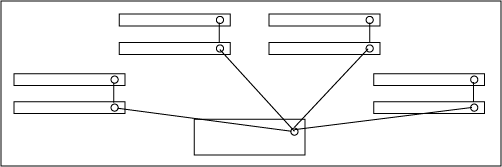

What happens when we connect a low impedance cable between chassis?

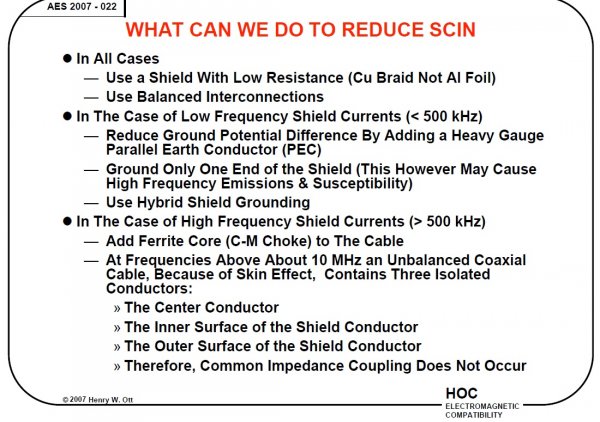

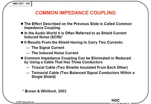

Same stuff from Henry Ott
so what I believe RogerD is achieving is a reduction in this Shield Current Induced Noise (SCIN) for low frequency shield currents (<500KHz):
- Reduce ground potential differences by adding a heavy gauge parallel earth connection
Exactly what RogerD is doing using a low impedance strap between the chassis of devices - dealing with these LF currents

Well chassis grounding or "heavy gauge parallel earth connection", as Ott calls it can provide a preferred return pathway for currents <500KHz, according to Ott
That does leave considerations about HF current noise, though.

Increasing the size of the safety ground reduces SCIN, but can also add parasitics elsewhere. For that reason I recommend some traditional forms of treatment that can reduce the overall amount of noise within the system to begin with. The most harmful sources from in on the AC cord, where as what's in the air is marginal barring RF generators (I mean literal ones). Well made gear isn't typically too susceptible to noise induction from stuff around it. I know people that separate out their cords so they don't touch but it so far has shown to either expose problems in their gear, or be diminishing returns x1000. I think getting cords off carpet might be about as far as one need truly go under decent conditions.
I would caution anyone trying to reduce SCIN by going wild with the ground conductor of an SE cable. I never recommend different sized gauges of wire, and hate coaxial. The benefits don't outweigh the sound. Simple twisted pair has the best overall balance between current, LCR, noise attenuation, and field suppression. Quad may work as well, but it's a mixed bag due to ga size, so it depends on application, generally prefer them for speaker cables.
jkenny, you're second post was all relevant. I don't think most can or need to make the connection to the first one. It doesn't really explain parasitics or anything. Most people have no idea what a ground plain theis or what inductance actually means... and why that matters with AC.
How can you reject more noise, when the nose is produced internally? Ferrite rings,blockers,EMI rejection materials don't work either. Granted a well designed cable can make a difference,but that's not a total problem solver. I have read many like comments but only a adequate parallel ground circuit will make a profound difference. The rest is just incremental and that is what the high end makes it's living on.

If the impedance is less because of the increased ground wire size, it becomes a path for more current that previously had another path. You divide noise into it. I can't say for all equipment, but there's plenty of noise parasitics from anything remotely near the chassis, often. The question is, was the path it took through some circuitry? Did it change the complex impedance negatively because it had a new place to go instead of being coupled? It's really a comment about the design of a device. Because of unknowns like that, my approach is not to use very large ground wires or try to make it act like a drain. It may work very well with some equipment, and terrible on others. As a designer it just isn't very practical to take a gamble when I can make something with no gamble.

Just to clarify what I was intending - my first post showed that, depending on frequency, return currents take different paths back to source - low frequencies (<500KHz) tend towards the path of least resistance; high frequencies tend to follow the path of least impedance. This is the behaviour whether on pcb or cables. Obviously, this has relevance to cables & to parallel earth connections in audio device performance & in audio device measurements.

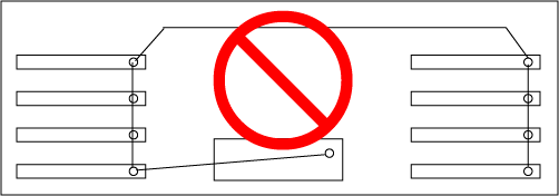

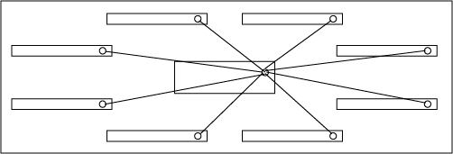

I posted elsewhere, this article from the Audio Precision knowledgebase in which they recommend, for optimal measurements, a star grounding scheme for such ground strapping.
"Recommended Test System Grounding"
Question:
What kind of grounding is best to use between the various devices in my test system?
Answer:
When integrating instruments, accessories, and DUTs (devices under test) into a test and measurement system, observing good grounding practice is always important in achieving optimal measurement results. Small ground potential differences between devices in the test system (such as switchers, accessories, the DUT, and the test instrument) can couple into the signal path and cause undesirable interference or noise due to the inherent stray capacitance between signal conductors and the chassis. To prevent this problem, Audio Precision strongly recommends connecting the chassis ground of each device directly to the ground of the test instrument via wires having as low an impedance as possible. This technique is often referred to as “ground bonding” or “chassis bonding.”
Star grounding
Diagram of analyzer in center with grounds radiating out to the switchers.
"Audio Precision strongly recommends connecting the chassis ground of each device directly to the ground of the test instrument via wires having as low an impedance as possible. This technique is often referred to as “ground bonding” or “chassis bonding.”
Bus grounding
Diagram of ground from analyzer to first switcher, and then daisy-chaining all the others.
"We do not recommend bus grounding (daisy chaining), where several devices are serially connected to a low-impedance conductor called a “ground bus.” The resistance in each leg of the chain puts the devices at different ground potentials, and is not as effective as star grounding.
Combination Star/Bus
Diagram of grounds radiating from analyzer to four switchers, and then a small jumper from each to another switcher.
When the serial links are very short, the combination star/bus grounding configuration can simplify connections while providing good grounding performance.
CAB-BOND Kit
Making Grounding Cables
Alternatively, you can make your own ground cables. These must be very low-impedance, heavy gauge copper wire, as short as possible for the application, and terminated with large surface area low-impedance spade lugs. If the lugs are a crimp type, make sure to use the proper crimping tool to ensure a secure, gas-tight connection. Fasten the one end of the lug to the switcher with a large, truss head screw. Attach the other end to one of the ground posts on the front of the analyzer.
And just a note for some people who read these recommendations from Ap & say "doh, what an idiot, our SMPS is plastic so no grounding can be done" - show some semblance of intelligence - does it really need to be spelled out what you should do or maybe you have to contact AP but beware they will think you are an idiot for asking such a dumb question - they certainly won't believe they are talking to an E'ee.
