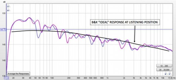

Recently acquired a pair of Kii 3s with a Control unit for a room with nowhere to place speakers except deeply into the corners. They're exceedingly transparent, with bass that's incredible (down into the mid-twenties with vigor) given their size. Here's the frequency response after using Acourate to tame two bass peaks and create a downward sloping target curve. I haven't yet really dialed in Acourate for this room, but early results are pretty promising:

Very interesting. It is rare indeed to see an actual frequency response in these pages. Just as an FYI, I superimposed the "ideal" B&K response at the listening position with the one you obtained. Congratulations. I wouldn't be surprised to learn that your setup provides a very satisfactory listening experience based on this aspect alone. https://www.bksv.com/media/doc/17-197.pdf

The various DSP settings help quite a bit. They are in a far from optimal room, so the DSPs are set for corner placement rather than free-field placement. That helps the low end response considerably, but the room is still lousy at the low end. There is a sharp 12db peak around 36hz that's making the low end appear overly high in the 1/6th smoothing picture I posted. Acourate already helped there, a LOT, but I still need to insert a notch filter to tame that. Still, very impressive low end response for such small speakers! If that notch filter doesn't work I will try to integrate the two subs in the room that I use for home theater applications.
Given the lousy room, Acourate helps at the margin to get a similar response across the two speakers through the lower midrange (90 to 200 hz or so) too. My target curve is still way "too hot" from around 150hz and below. That's my next series of iterations, and I'm likely to get a lot closer to the curve Marty superimposed.
Again, another example of how psychoacoustics matters when designing the "perfect" response. Most speaker manufacturers would cringe if their speaker measured with such a slope...

They would cringe if these were anechoic measurements. These are not. Pull out your phone app, put on some pink noise and see more or less what your inroom measurements look like. For kicks now put on music, set response to slow and see what you get on your system.
