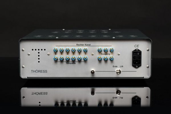

One ground terminal for 6 inputs!! crazy stupid.
If you order new, you can customize. I had 2 ground terminals on my Thoeress.
shakti
May 9, 2015
1,437
2,396
480
Cologne, Germany
The separation of the rca plugs worries me a little. They seem on the picture to be very close set indeed. Would this prohibit some of the fatter cables?
The Thoeress is a full size PhonoStage, so fatter cables do work.
I know, I did the same thing on my TW/Thoress mk1 3 input phono stage. But it is stupidity that you even have to ask.

djsina2
May 30, 2019
1,145
979
213
Here's a picture of the mk2 version. Notice the two grounds and also the "parking spots" for single coil mono. Maybe your picture is an old one?
