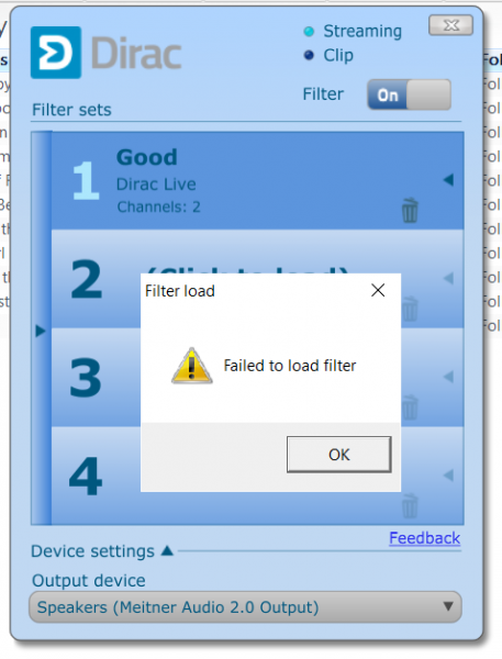

    Hello
    I am evaluating Dirac package, opened a ticket with their support, but it is somewhat slow..
    Setup:
    Windows 10, running JRiver 21 output going to EMM XDS1 via USB (ASIO)
    With UMIK-1 created filter, saved it and also the project.
    Then set the output device to WASAPI-based Dirac Processor (aka virtual sound card), and the sound came very distorted.
    When trying to load generated filter, get a generic error 'cannot load filter' without any kind of specifics (what, why?)
    Then just switch off the filters using slider in the processor panel, but still the sound was distorted
    In processor panel the output device is set to same ASIO Meitner Audio
    Any clue?

    Yes, I've checked and played with the attenuation last week, it is -8db, however the filters are OFF anyway, so Dirac should not do any processing, but rather passthrough
    It is ASIO, checked also with WASAPI.. No much difference.. ASIO was OK when measuring, though
    The sound is not just distorted, it is like the very poor cellular connection
    Is it a big company, Dirac? Wonder why these guys gave me their first response from the helpdesk after couple of days, and now it is 3 days since I haven't heard a word from them
