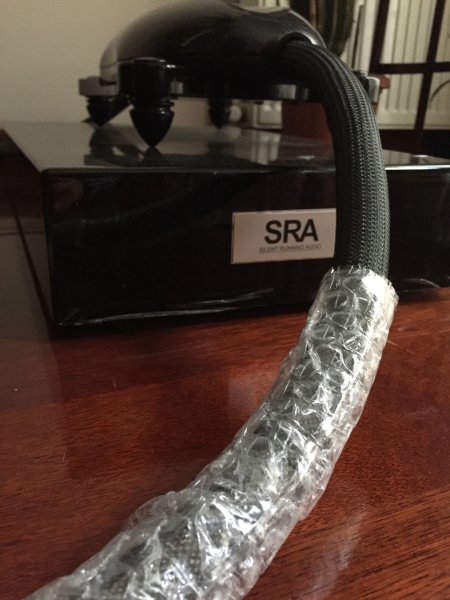

i wrapped the cables with bubble wrap and bought anti static gloves to touch the equipment. will report the long-term effects

Uh, unless it is anti-static treated, bubble wrap will increase static charges/discharges... And anti-static gloves don't help if you are not grounded to begin with. Studies show they can actually hurt by providing a lower-impedance path for discharge. You must discharge yourself before touching the equipment. You could try picking up a wrist strap that you put on (or at least grab) or provide some other grounding means. In the past I have put down an antistatic floor mat and made sure the equipment rack and equipment had a good ground so ESD had a path outside the components. The floor mat doesn't help much if you step on it with rubber (insulating) soles but will help a little even then.
Wrist straps: http://www.amazon.com/s/ref=nb_sb_n...wrist+strap&rh=i:aps,k:antistatic+wrist+strap
Floor mats: http://www.amazon.com/s/ref=nb_sb_n...ic+floor+mat&rh=i:aps,k:anti+static+floor+mat
You must have ground wires on these products.
At some point I could pull one of my old presentations on ESD and post. It is a big problem here since the air is dry and we work on sensitive electronics. I have seen a half-million dollar piece of test equipment get killed by someone walking by and inadvertently brushing the probes with his jeans...
