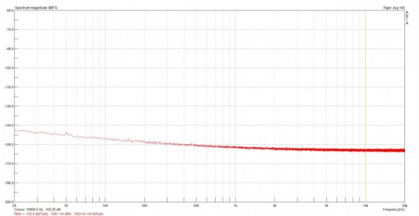

Below is the noise floor of my TI ADC. Below that is the noise floor af a cheap Sound Blaster X-Fi, after a few simple mods. It did suffer from a lot more noise and spuria before.
