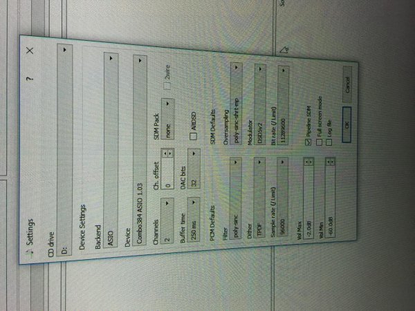

Now to get the best out of it. You need to ensure the settings are right. I'll provide you with my favorite settings, and you can tweak from here.
First thing is to go into the Dsdiff/DSD settings and ensure DirectSDM is checked:
Then go into settings and set everything exactly to these settings. The only difference is the ASIO device will be different. The PCM settings don't matter, so put to whatever:
Then on the main screen, once file is cued, make sure these settings are enabled:
Now sit back and enjoy the best PCM you've ever heard :)

That was very valuable - I have set up to your defaults (on OSX atm so core audio and DoP) and agree with your conclusions.
Excellent contribution to my thread - cheers
I'm having some attachment glitches with the last post. Can't seem to delete the double screenshot.
Anyways 1 more tip, it will sound better with Windows as it with allow bypassing core audio with ASIO, and streaming DSD natively. They don't like telling everyone that as it will scare Mac guys away from the product.

Sorry to intrude... just a little add-on to what Blizzard suggested.
DirectSDM is only useful and applies to DSD files, as it keeps them in the same untouched format. It does not apply to PCM upconverted files.
I would set Vol Max to -3dB as there are quite a few recordings that have digital clipping at -2dB. Therefore, -3dB is a safer setting.
In SDM defaults try also DSD7 as modulator and compare with DSD5v2 to your likeings.

DirectSDM also applies to PCM upconversion as well. It bypasses the volume control, and the extra layer of filters. It clearly sounds better upsampling PCM on my unit.
But yes the -3db and DSD7 options are good to try.

DirectSDM means that no DigitalSignalProcessing is applied to DSD, that includes volume control.
In the case of PCM>DSD upconversion, when a PCM file is converted into a DSD, the DSD file is not going to receive further DSP.

For some reason when I have DirectSDM checked when upsampling PCM to DSD, the volume control is disabled, and a veil is removed from the sound. Not a small veil either. Noticeable enough that I know when it's not checked clearly. This is part of the reason I'm using an analog volume control with my DAC, instead of the HQplayer volume control. My DAC is chipless, and extreme high resolution, so maybe it's harder to notice on some DAC's. Let's see if Andrew can tell on his NADAC. Listen to something very delicate and vividly clear. Like stringed instruments.
