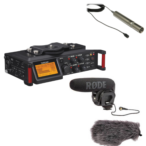

Most on-board sound with pro-summer cameras is good, but not pro quality. The main factor is the noise floor and you also have limited functionality. I have a Rode mini-shotgun mic, which can attach to the camera and plug into the camera mic input. I have this Tascam 4-channel recorder for situations where I need more than one channel, such as an interview, but most of the time it’s more convenient to record the sound on the camera. I also have a wired Sony lav mic for those interview situations; a wireless mic is more convenient, but you need to spend some money to get a wireless mic with immunity to RFI problems.

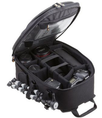

This backpack from Amazon Basics can hold one or two camera bodies or a few lenses. It holds a lot of stuff and works well for shooting on the go.
