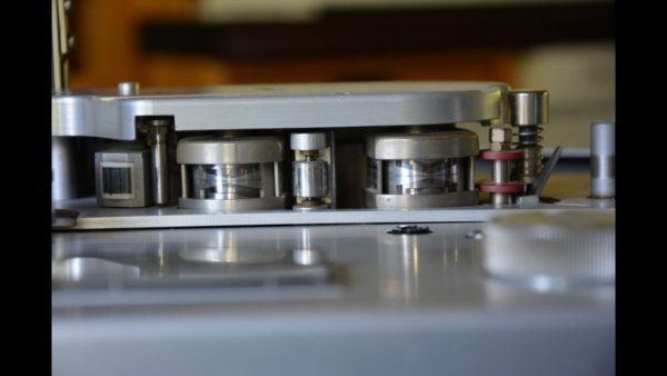

Got myself a Studer A80 R with direct head output to XLR connectors
