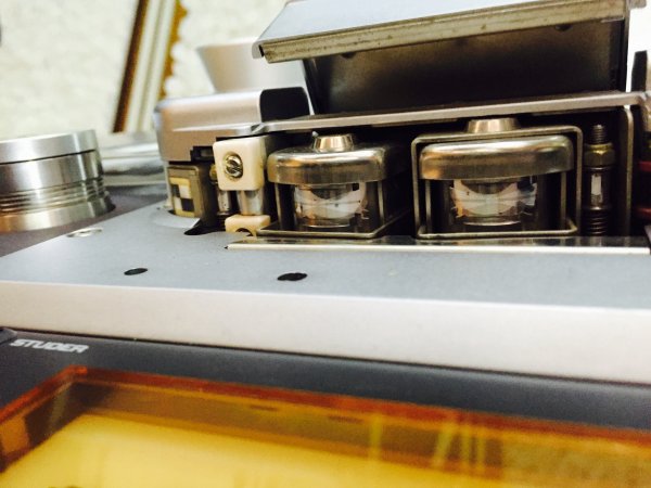

Do not know how to upload video . Took a snapshot .

Your photo of the A810 with its VU meters being off tells me that your 4PDT head switch is in internal electronics position and the issue is with Studer repro electronics. If the switch was in direct head position, your VU meters will be inoperable considering no CH1&2 signals being fed.
