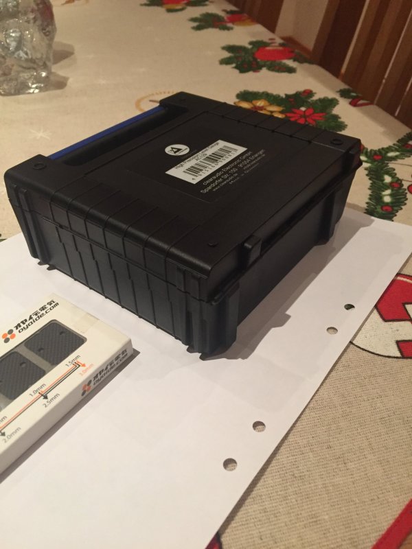

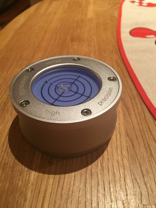

I use the Clearaudio ”High Precision” Level Gauge Precision Bubble. Calibrated and VERY accurate. Easy to use and stored in a very nice hard case box. Though quite expensive. Behold ;) !
/ Jk
