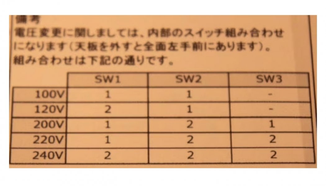

I have just bought an 18 month old Krell Evolution 2250e power amplifier for my French house. It is a Central European model 220v 50/60Hz. The voltage at my French house is around 245V, so to prevent it running hot, I think I should alter the dip switches next to the toroidal transformer for 240V. Are the settings the same as in the KAV 300iL I use in my UK house, which I believe are as follows:
1-1-1 110V
2-1-1 120V
2-2-1 220V
2-2-2 240V
My KAV 300iL, which I bought from a Japanese friend, when he gave up his apartment in London on retirement, was Japanese spec at 110V/50Hz and he used in the UK with a 240 to 110V transformer. The UK Krell agents, Absolute Sounds, wanted £400 to change to 240V. However, I was given the above information by a service engineer. I took the lid off with the Torx screws and changed the three dip switches from 1-1-1 to 2-2-2 in around 30 seconds. I was a bit nervous about switching it on but it has now been working perfectly for 3 years, so I must have got it right. The quoted price to do this job by the UK agent falls under the heading "total rip off". I would like to do a similar job on the 2250e.

The secret squirrel seems finally to have been put to bed at Krell :). They have actually confirmed to me that the dip switches next to the toroidal transformer should be changed to 2-2-2 for 240 volts. At the moment they are set to 2-2-1 for 220 volts. Krell strongly recommended that I did change the voltage on the 2250e from 220 to 240 volts, as my supply in France normally runs at around 242-243 volts. This is in total contrast to a few years ago, when Krell said they could not give any information to customers about doing things "under the hood" and would only recommend that they go to their local Krell dealer. Common sense rules!

Hi, this movement swhitches its the same case for 302 or 402e ?
Since these switches seem to be the same between the quite different era and class of my KAV300iL and Evolution 2250e, I would guess this is a standard Krell feature. It certainly worked for switching my KAV300il from Japanese 100v to UK 240V (1,1,1 to 2,2,2) and on the 2250e from Central European 220V (1,2,2) to France 240 (2,2,2). Wilson

thank you.
I saw 302 and 402 have 4 switch
I would suggest that you contact Patrick Bresnahan at Krell. Given the cost of my 2250e I did not want to risk damaging something by switching to a lower voltage than I was actually using. He confirmed to me that 1,2,2 was 220V and 2,2,2 was 240V. This sort of information used to be regarded as top secret at Krell but maybe that was in the D'Agostino era and no longer applies. Patrick was very helpful to me also, with information on lightning precautions, as my house in France is built right on the edge of a 1000' escarpment and is the first thing that storms hit. In summer, my area (The Var) is very prone to violent thunderstorms and the house has had two lightning strikes in the 12 years I have owned it. Wilson
