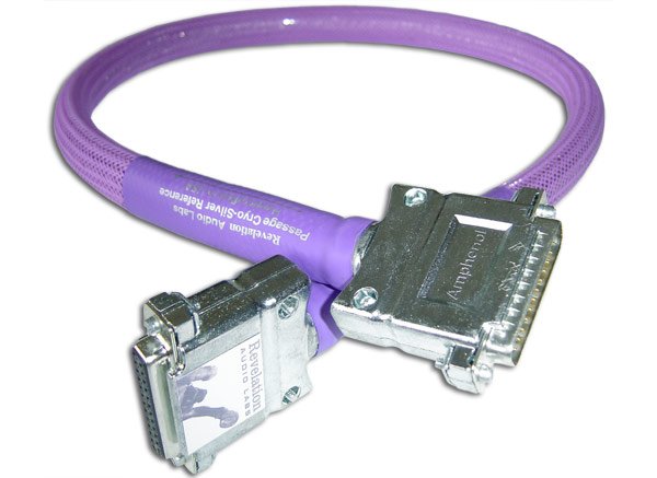

Pass labs have done that with the Xono in previous shows. before the XP-25 was released they were thinking of releasing the XONO with dual power supplies.
Wally of Wallytractor fame has/had an XONO with dual power supplies. he said an excellent upgrade.
have you upgraded the umbilical cords? users have repported nice upgrades in SQ with the cords from Revelation audio.
http://www.revelationaudiolabs.com/cables-power/

Yes, I also suspect that the power supply is what might be at play here - the XP-25's doesn't look beefy enough and I was looking to use larger capacitors. PeterA also mentioned this umbilical a while ago, but I refuse to use anything with Amphenol connectors, such as this and, oh, Transparent interconnects :D
