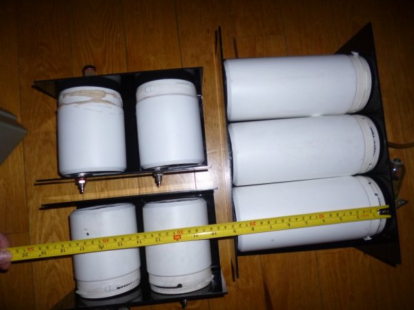

I attach a photo of the original surge tanks (nice name for some cheap plastic jars) - the double ones are for the platter and flywheel, the triple one for the arm. My turntable is the AirForce one and came with three SPP6Ga pumps - 6lpm /9.8 kPa - one for each part. One of the surge tanks of each block gets the air from a filter and supplies it to the pump input. IMHO if you use large surge tanks and pressure regulators the type of pump is not too important any more, as long as you have some excess of air flow to allow adjustment. enough. Do you need the Forsell instructions to adjust the pressure?
Can you tell me the airline and fitting size data for the fitting shown in your surge tanks?
I am not sure if I can source correct metric type air fittings readily. As I am having to learn the pneumatic world, we use:
NPTNational (American) Pipe Tapered Thread
and Europe uses one of the below thread standards:
BSPT (R)British Standard Pipe Tapered Thread
BSPP (G)British Standard Pipe Parallel Thread
By the looks of it, the airline is about 6mm O.D.
Thanks, Francisco.
