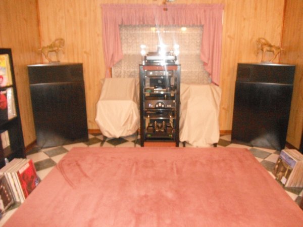

Ethan, from the picture (attachment) of Jay's first original post they look like Klipschorn speakers (corner horn type).
=> http://www.klipsch.com/klipschorn-floorstanding-speaker

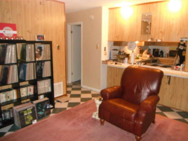

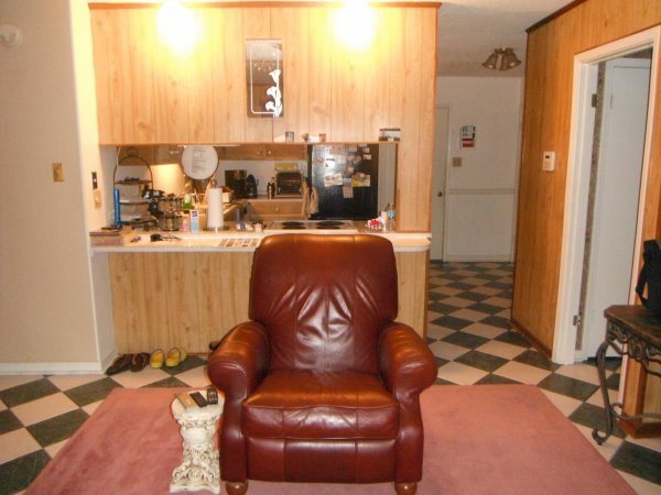

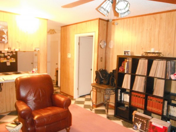

Ethan,
The speakers started life as Klipsch Corner Horns, the only thing Klipsch now is the cabinets and 15" woofers. Everything else has been upgraded, the mid horns are now wooden with a full tractrix flare 2". The mid drivers are 2" BMS, the tweeters are APT 200's 90*X90* horn. The xovers are crossed at 400hz and 6000hz. I think the specs are from 35hz-22,000hz. The coffee table is gone!!!
Ethan this is the room today and pretty much everyday...
You'd benefit greatly not only from bass traps, but also absorber panels on stands at the left and right side-wall reflection points. (Though if you can move the shelves out of the way, panels could go on the side walls directly.)
--Ethan

Ethan,
The shelves can not be moved that is all there is to it, I will have to work around what i have in the room as it is... I tried to build a dedicated room but the parish gave me so much static they made it impossible so I gave up. The room i have is all I have so from there is where I go...
--Ethan

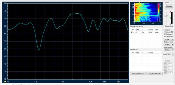

Absolutely the first thing to do is to take some room acoustic measurements and analyze them to determine where your issues are. It is impossible to generically tell you how good or bad your room is without acoustic measurements, especially because your room is not rectangular and is more open plan. Once you have taken acoustic measurements then you are in a position to determine what the root causes of each acoustical issue are. From root cause you can identify the solution and select one that meets your practical, aesthetic and budgetary needs.
For example if you are primarily concerned with the bass then generally the issues are caused by room modes and the 'levers' we have to change that are: speaker position, listener position, acoustic treatment and EQ. Depending on where your bass issues are most moderately priced commercially available bass traps may be wholly ineffective when deployed in small quantities. In you room you may also have speaker boundary interference peaks and dips to worry about.
If you do not have patience to learn how to take and interpret acoustic measurements using REW you might want to use a simpler tool such as XTZ Room Analyzer which gives you usable graphs right out of the gate without need to configure scales, use loopbacks, etc. Particularly in the bass region XTZ is probably the easiest tool there is to work with as the key information - frequency response, time decay and the effect of EQ is all on the same page in the software.
XTZ screenshot:
