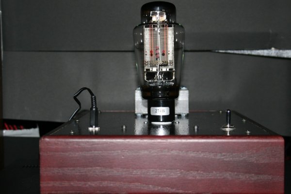

OK I ended up going with a hand built unit from Aural Thrills, they advertise on audiogon, I looked into Tom's work and decided to give one a try, and I sure am glad I did. This unit is a two piece unit consisting of a tube rectified 274B power supply and the preamp itself using 4 12ax7 tubes. The total price including an Emmision Labs 274B and 4 NOS Bugle Boy 12ax7 tubes was right at $2000. I will write a review after using the unit for a month or so, but right out of the box I am very pleased with what I am hearing.
