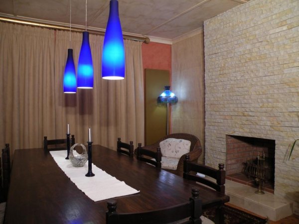

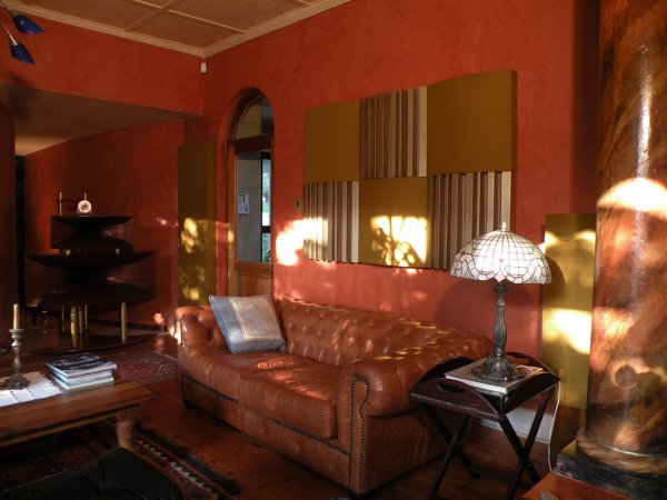

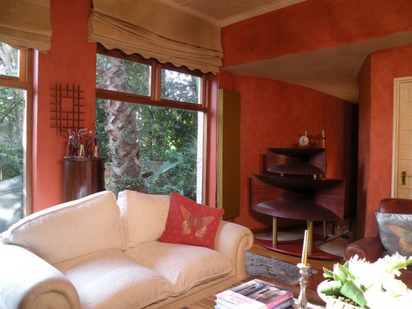

Exposure to a number of overdamped windowless sonic bunkers let me to believe that all sound treatments were undesirable as these spaces always made me feel disorientated and acutely aware of my body’s fluid dynamics.
When I built my speakers into the structure of my 1920s solid brick and mortar home, I enlarged all windows, albeit with horrendously expensive sound proof glass giving a splendid but quiet view of the garden. Curtains were not even considered as I believed furnishings and bookcases would be more than adequate. That was until the first notes were played. Whilst there was no echo or overtly bright sounds what was immediately apparent was that although the back wall was some 35 feet from the speakers, the horns were acting as perfect projectors creating a marvellous 3D picture at the opposite end of the speakers! Thick acoustic blinds and curtains were fitted to tame this. The sound was good as were the measurements and as horns are controlled dispersion devices side wall treatment was surely not necessary?
Problem was that the rear wall was still playing subtle tricks. There were still reflections from there that no amount of carpets, bookcases or wine racks could control. These reflections would be thrown straight back at the horns where the horn would then act as an concentrator ,for those same waves to be reflected and re amplified in a never ending cycle.
Grudgingly some room treatments were brought in to tame the back wall. Stripping the room and rebuilding to hide these was as impossible as a number of aesthetically challenged free standing screens, so compromises had to be made. Probably less than the actually needed panels were installed but so large was the improvement that many other surfaces also were treated allowing some furnishings to actually be removed and leading to what I believe is visually a more harmonious space. My firm belief that horns do not need for sidewall reflections to be damped was destroyed by a short session although these need to be at slightly different positions than with conventional speakers.
Have I done enough? No but we still need to live, laugh and eat in this space.
