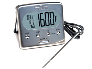

Cooking is certainly fun and reading all of your threads on items cooked serves to stimulate my salivary glands. One of my concerns is the inaccuracy of the temperatures in the oven as determined by the oven internal thermometer. I find all too often that the probes that come with the oven are also inaccurate. Is this just my impression or do you feel the same? If so what thermometer or other method do you use to get the most accurate temperature determination?

That one looks pretty serious Steve. You don't trust it?

I have one of all-clad's too. I cook for done-ness by temperature and that's a good probe. I also use the ThermoWorks Thermapen 5 because it reads almost instantly.
You can also use an IR thermometer to check for the oven temperature.
I use a Fluke model 63 IR thermometer. It's good for testing the temps in the freezer and refrigerator too (as well as your AC duct temperatures and many surface temperatures that you can't stick an immersion thermometer into like saute pans, walls, amplifier heat sinks, etc).

Hi Steve, that gadget that you have is perfect for checking oven temperatures. Bear in mind that your oven probably has hot and cold spots so you should move it around a little to get an idea. I use my Rocks BBQ Stoker to keep an eye on the oven and food temp. It's great, because I can add as many thermometers as my budget allows :)
