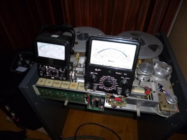

So, besides Spectraplus, what other software is recommended?
This audioasylum page debates several packages.
http://www.audioasylum.com/cgi/vt.mpl?f=tubediy&m=212146
For very basic measurements sometimes I use the excellent free Soundcard oscilloscope - the generator even includes a programmable sweep, independent channels and phase angles. When used with the graphical cursors is is accurate enough for tape service purposes.
http://www.zeitnitz.de/Christian/scope_en
But the secret trick for excellent tape sound is carrying the last measurement with a good old analog VOM - it purges the system from any residual digital nastiness.
